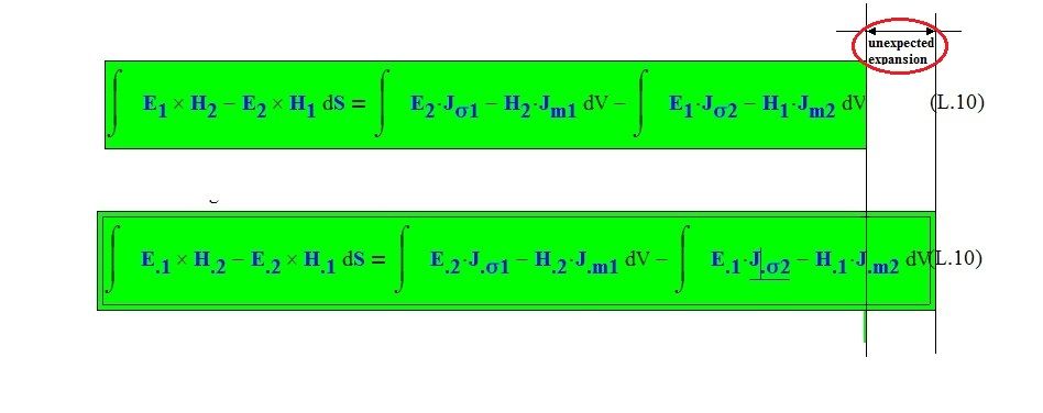

I would like to point out to the PTC programmers, the following annoying Mathcad 15 abnormality that is when I click on a formula the formula is enlarged as shown in the following picture:

What you find annoying I find helpful.
Helps me find the literal subscripts where I wanted an array index.

It happened (still happens) in previous versions of Mathcad, like e.g. 11.
And I agree with Fred that it's mostly helpful.

I, too, think that this behavior of showing the dot for literal indices when editing an expression was there all the time. At least in the windows versions of Mathcad. I must confess that I don't remember how it was displayed in the DOS versions.
There has to be a way to distinguish between literal and matrix index - at least when yo edit an expression - and showing the otherwise hidden dot is one intuitive way of doing so. I even would prefer if literal and matrix indices would be better distinguishable in normal display mode, too. There is a difference (the matrix index is lower) but its hard to spot and usually is only noticed in direct side by side comparison.
In Prime they have decided to change the display of the matrix index when editing a region (and the region does ot change in size here).
You may argue, that's better, but on the other hand creating a literal subscript via "Ctrl -" is now more cumbersome.
I never have seen that behavior in Mathcad as an annoyance but I can understand that Francesco is irritated by the temporary width-change of the region when its selected for editing.
The same happens sometimes in 2D-Plots, too. Its irritating (as the aspect ratio changes) but I am very happy that the plot region shrinks again when its not edited - making for a nicer compact display in the report. This in contrary to Prime, where plot regions usually take up far too much space and that way optically destroy an otherwise nicely formatted document.

I didn't refer to the subscript. When I click on any point of a formula, this action causes enlargement of the formula. Indeed, the larger the size of the formula, the larger the expansion is, of course.
I would like to add that the problem is even more evident when two or more worksheets are displayed tiled vertically.

Ok! it seems there is nothing to do, given that enlargement is caused by showing all the dots of the subscripts that in normal conditions are occulted.
