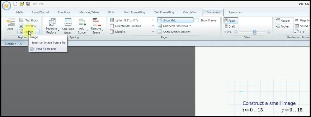

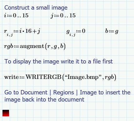

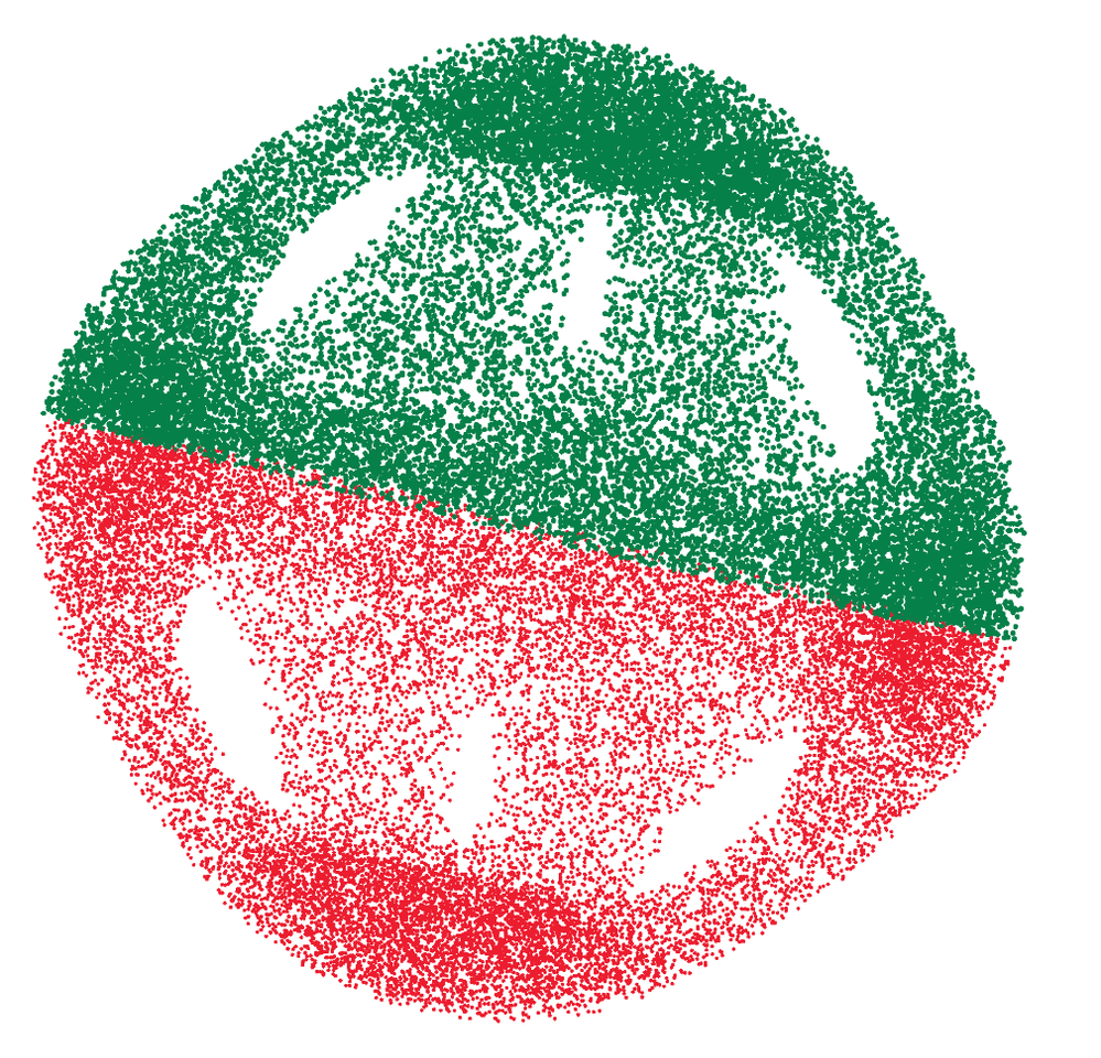

Yes Prime 8 can generate theoretical images as in Mathcad 15.
Construct a red, green, and blue channel and augment them into one larger matrix.
Save this image to a BMP file is simplest.
Then use Document | Regions | Image to insert the image into the document.
You could also change the rgb to hsv and save as a JPG etc.
Look at all the options under Functions | Functions | Image Processing
