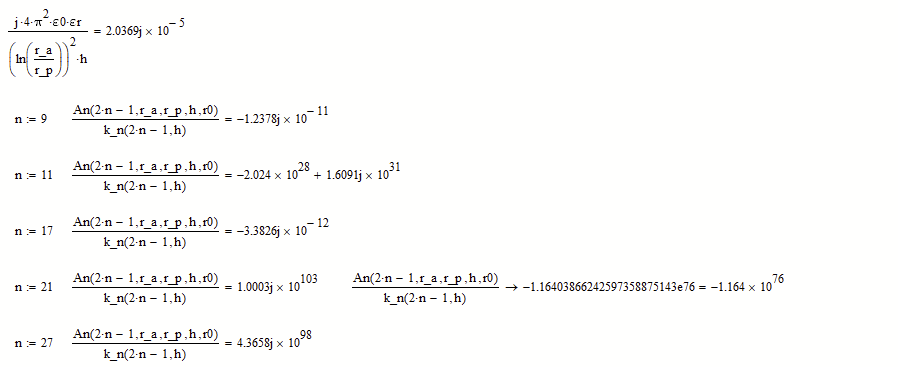

Is it possible to to index the summation for odd numbers in 15?

I tried to follow the same method in my original programming but the solution does not converge while matlab can
Can you share your views

You may want to look at the functions An and k_n.
The constant factor in C_b is a quite low pure imaginary number and for most odd values of n the summand is a very small imaginary number , too. But for some odd values of n the summands seem to "explode".
This may also be due to numerical inaccuracies - compare the result of the numeric to the symbolic evaluation shown in the picture for b=21. But both values are quite large so you may want to recheck your function definitions.
There is also a significant difference when I evaluate C_b (for m=41) when evaluated symbolically:
I just noticed that when you define the function An you already have k_n(n,h) in the denominator. When you define C_b you have the same function again in the denominator of the summands. Guess this was not done on purpose?
BTW, you should omit the first argument n in your function definition of C_b as n is the summation index anyway.
