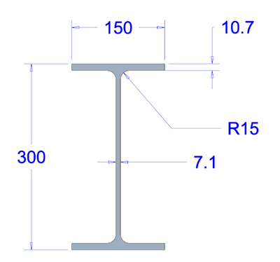

Scenario: You have a standard 300mm steel I-beam with a length of 12 meters. It is simply supported at one end and at 8 meters from that end. There is a load of 5000 Newtons in the middle and 10000 Newtons at the unsupported end.
  • Calculate the cross-sectional area of the I-beam.
  • Calculate the cross-sectional moment of inertia about the midpoint of the beam. (You may choose to ignore the contribution of the fillets. If you want the additional challenge, you may include them.)
  • Use the Chart Component to display shear and bending moment diagrams.
  • Calculate the deflection at the end of the I-beam.
You may ignore the effect of the fillets as necessary for shear, bending moment, and deflection.

Hello Dave, please confirm the boundary conditions. The statement says that the beam is simple supported at one end and at 8 m from that end. Per the image, it seems that it is fully anchored at one end and simple supported at 8 m from that end.
Simply supported at both locations. Per the image caption, I made it using Creo Simulation Live and used the Fixed Displacement constraint, thinking it would convey the idea. Perhaps that was wrong. But go with the verbiage, simply supported at one end and at 8 meters from that end.
