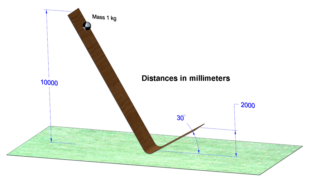

A ball with a mass of 1 kilogram is at the top of a frictionless ramp 10 meters above the ground. The ball rolls down the incline and launches from a height of 2 meters and an angle of 30 degrees above the ground.
(This picture was created in Creo.)

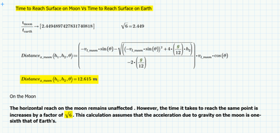

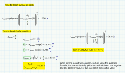

  4. How will the horizontal distance change if this were performed on the Moon instead of on the Earth’s surface? Assume the acceleration due to gravity on the Moon’s surface is 1/6 that of Earth.

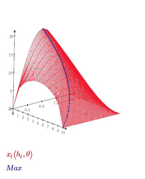

  6. Use a 3D Plot to show how the horizontal landing distance changes as a function of ramp height and launch angle. Assume the ball starts at a height of 10 meters.

Can we assume that the ramp angle (from 10 meters) is also 30 degrees?  (Otherwise the horizontal velocity requested in #1 is not fixed.  Or do you want that discussed too?
The function should calculate horizontal distance, not velocity.

Yes, that is clear, but the distance will probably depend on the speed reached.
And this still does not answer the question whether the two legs of the ramp actually enclose a right angle, as one could assume on the basis of the drawing.
So is the angle of the longer ramp 60 degree to the horizontal plane or should it be considered variable?
Here are a couple hints: potential energy gets converted to kinetic energy. The angle between the two legs of the ramp does not matter. I almost threw in the horizontal length of the ramp as a red herring, but I thought that might get people too caught up in the angles of the ramp. And even though I drew the angle between the two legs of the ramp at 90 degrees, it actually doesn't factor into the answer.
Dave Martin - dmartin@creowindchill.com - https://www.mcaeconsulting.com
OK, but when the ball reaches zero height and is supposed to switch on to the 30° ramp, a part of the energy would be transformed into deformation and heat (even when you assume frictionless motion). How much depends on the angle of the first longer ramp.
But I assume that you want us to neglect this as well and also assume a non-elastic ball with a diameter of zero so also the geometry where the two ramps meet is not of importance, right?
Yes, please ignore deformation, heat, and diameter/volume of the ball. Essentially it's a trajectory problem where the initial velocity comes from potential energy.

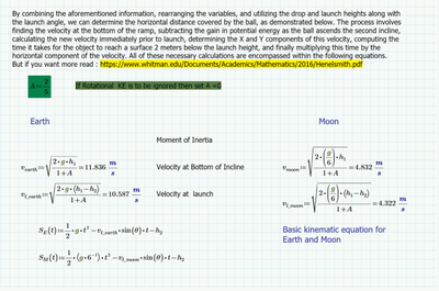

My Attempt
ppal
(To:DaveMartin)

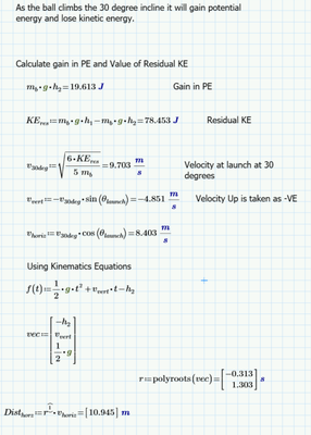

So i get
for the first iteration . Used Moment of inertia of hollow sphere .
Anyone can confirm or dissent before I go further?
24-Ruby V
(To:ppal)
I have not spent much time on it so I may had made mistakes,  but I ended up at approx, 17 meters
The desired function would be
or

Comments on my approach - Prime 9 attached
24-Ruby V
(To:ppal)
Since the size of the sphere is not specified, I assume that it is simplified to be a point mass and things like rotational energy should not matter. @DaveMartin  could go into more detail about this.
EDIT: Ahh, I just noticed that he already wrote that the diameter of the ball should be ignored as well. So I guess that we should also assume that all kinetic energy is in translation and none in rotation. The ball is sliding down and up the ramp and not rolling, hmm...

The main point was to get to charts and 3D plots in steps 5 and 6.

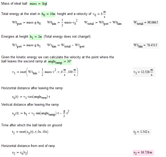

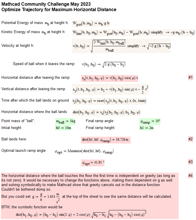

So anyway here is my entry - out of competition as it was created in Mathcad 15. But this version allows a much quicker and faster workflow and is significantly more convenient to use. Quite apart from the fact that it is also more powerful in terms of functionality.
I briefly tried converting the file to Prime 9, but despite the fact that it would have required a lot of reformatting to make it look anything like the same, I also had to refuseto put up with the many shortcomings of Prime and the converter to bang around. The well known auto-label bug has struck again - h has become a constant, g an undefined variable without a way to change it. And Prime's inability to deal with incomplete functions would have required a workaround in calculating the optimal angle. I didn't even get as far as the plots then. I quickly gave up trying to create a Prime Worksheet, very disgusted, and instead attached a PDF Print in addition to the Mathcad file.
Have fun!
Here the pics of the two pages

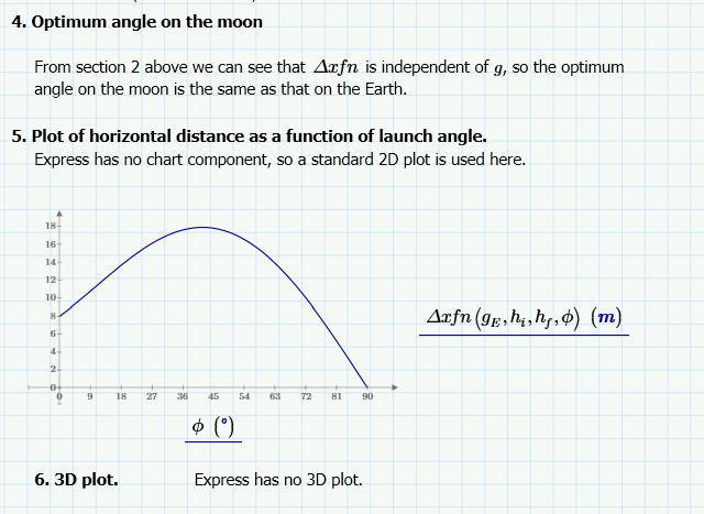

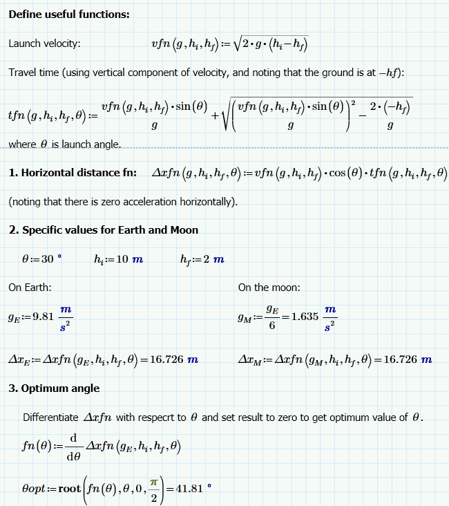

Looks like you got the trick answer to #4. The acceleration due to gravity falls out of the equation. So it doesn't matter if you're doing it on the Earth, the Moon, or Pluto.
Solution attached, Prime 4.0 Express

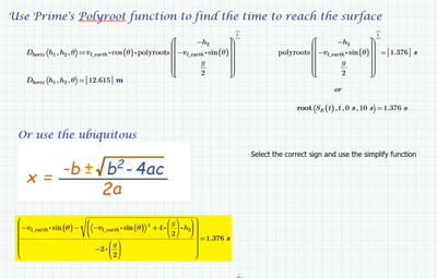

My submission in Prime 9.0 format.

Ignore rotational kinetic energy. Prime 9. No Chart Component but x-y plot. Without units to solve.

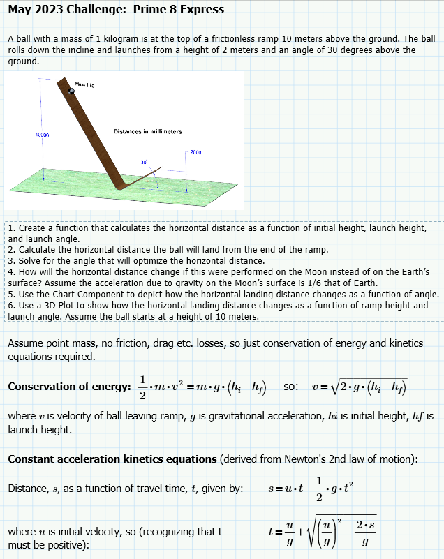

Here's my limited attempt with Prime 8 Express:
If it's a ball, why does the incline need to be frictionless?  The intent of a ball is to have it rotate.  For that to occur, you need nominal friction.
If you want the incline to have friction, add friction. If you want to incorporate that and rotational inertia, have at it.
I will repeat my original intent. I modified an old high school problem, where the intent was for people to use the potential energy to find the initial velocity to calculate a trajectory. Anything else you want to add to the problem is up to you.
As with the previous Mathcad Challenges, the point isn't the answer you get, but how you choose to approach the problem with the tools in Mathcad.

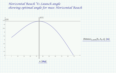

Good evening fellow friends of Mathcad Prime,
Please find my contribution in attachment (Mathcad Prime 9).

Looks great. Is your launch height and landing site at the same level?

You're right: I've made a mistake and I'll correct this tonight...

In attachment the reworked version v2
