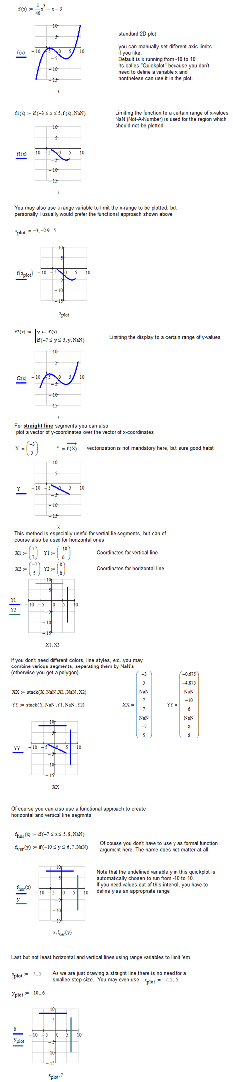

It wasn't really clear to me which plots you actually expected.
So I provide some general informations about plotting, limiting plots in x- or y direction and plotting line segments.
MC15 file attached

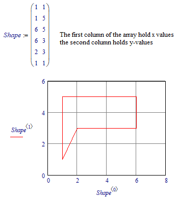

If you actually want to draw line drawings in the plot, you may be better off defining an array.
(Note that an array is something different from a range!)
Here's an example

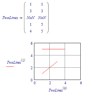

And you can draw multiple shapes using just a single array. Points that contain NaN values are not plotted, so, to draw two separate lines you can:
I saw this response second and was a bit confused but got me on my track to finishing up my graph, thanks for posting a second option so quickly.
MC15 file attached

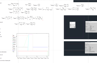

This explanation and option was really helpful, thanks for the mathcad file that allowed me to quickly see the different examples and quickly mess with them and better understand the information presented. I used this the most fixing up my graph. It's still a bit in progress because I am trying to possibly add the loads as vectors but I am not entirely sure how to do that. I haven't explored it too much yet as I am also figuring out how to best represent different load triangles or if I will at all. I've attached a semi-messy updated document to this reply because I thought it was cool to see the graph function. Its midway down the document if you want to check it out in more depth. I'll also probably look into stacking up some of the lines to have them be the same and less messy.
