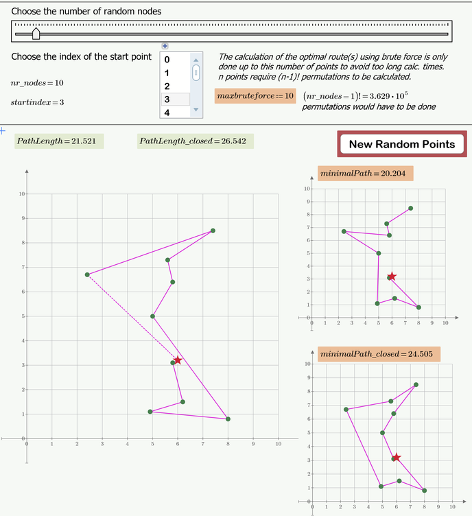

So it seems that you are just looking for something like this?
EDIT: Added the 3D version
Prime 10 sheet attached
Second version of my sheet.
Fixed an error concerning the selection of the start point.
It should read "nodes3D" here instead of just "nodes".
I also added a comparison of the path found using the greedy algorithm with the real minimal paths (both open and closed).
The minimal paths were found by brute force, calculating the path length for all paths with a constant starting point and all permutations of the remaining points. This is only feasible for a small number of nodes, so I added a threshold which avoids doing the calculation for a larger naumber of nodes. Set it to a higher value at your own risk 😉
We see, that the greedy algorithm sometimes really finds the minimum, often it doesn't but yields a solution which most of the times can be considered a good approximation, given the simplicity of the algorithm.

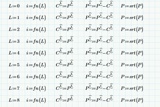

Here's a slightly cleaner set of the iterative calculations in my worksheet.
If only the row select would accept the function fn(L) instead of insisting on an integer, I could create a single line function with L:=0..n-2.
Alan
