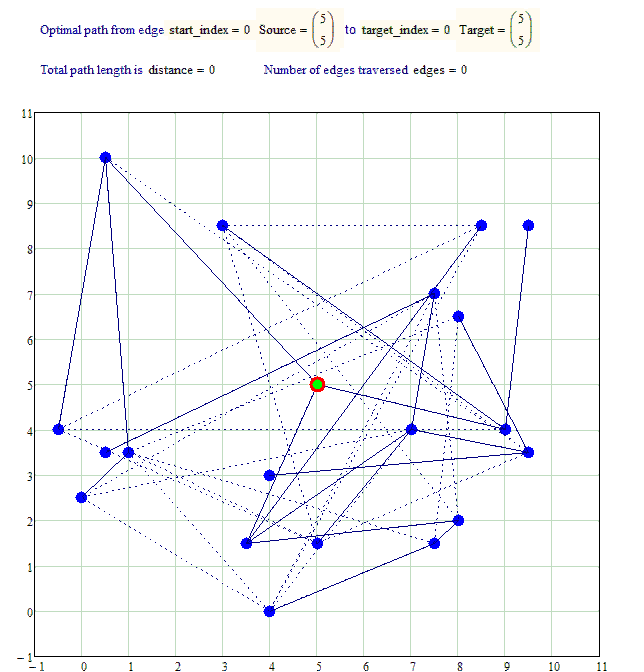

This month’s challenge is a programming challenge inspired by Dijkstra’s algorithm, which finds the shortest path from a single source to all the other nodes in a network, based on weighting.
In this scenario, we will use points in a 2D plot, where the weighting is the distance between the points.
Challenge 1: Known Points
For the provided points, write a program to calculate the shortest path from the first node (5,5) to all other nodes, always choosing the shortest path from the current node.

Simply specifying the points is not enough! A complete specification must also specify the available edges.
Because if every connection is to be possible, then the shortest path to every point is trivially always the direct connection, if, as stated, the weight of an edge is to be the Euclidean distance.
So what is the complete specification of the challenge? We need a list of edges along with the list of points and the weight information!

You can consider the available edges to be from each point to every other point. The weight is the distance from the current point to the other points.
That's what I meant when I wrote that in that case we would not need any algorithm because the shortest path always is the direct connection of start end end point. After all we are in Euclidean space.
I don't believe that's what you had in mind.
There would only be further point on the shortest path if three or more points happen to be collinear.
The question of the shortest route only makes sense if not every point is directly accessible from every other point.
Or did I completely misunderstand the task? I thought the task was to use Dijkstra's algorithm to determine the shortest path from the starting point (5;5) to each of the nine points. That is, for each of the nine points, the list of points visited along this path and the total distance traveled.
There is no specified end point. Only a start point.
Let me give an example. Let's say we have points A, B, C, D, E, and F. A is the start point.
We then look at the distances from A to B, C, D, E, and F. Let's say that the distance from A to E is the shortest. That is the path we take. Now we're starting at E. In case I need to say it, once we visit a point, we can't go back to it. Now we look at the distances from E to B, C, D, and F. Let's say the shortest distance is to C. That is our next point. From C, we can now measure the distances from B, D, and F. The shortest path is where we go. Until we visit all the points.
And for this challenge, you don't even have to start at (5, 5) like I specified.
Dave Martin - dmartin@creowindchill.com - https://www.mcaeconsulting.com
(To:DaveMartin)
So what you have in mind is kind of a round trip but without closing it - we do not have to come back to the starting point. The distance from the last point visited back to the start is not taken in account, correct?
Actually a travelling salesman problem but solved just using (local) greedy algorithm which most of the times won't find the optimal route.
And because the round trip is not closed and because only a simply greedy algorithm should be implemented, changing the starting point usually will result in a different route.
I misunderstood when you wrote "shortest path from the first node (5,5) to all other nodes" because I interpreted it in the sense it has in Dijkstra - which would mean to calculate the shortest route from start to A, and also the shortest from start to B, etc.
So I thought you wanted us to implement the Dijkstra algorithm which would have made no sense if all points are connected
But the challenge actually has nothing to with Dijkstra, correct?

So it seems that you are just looking for something like this?
EDIT: Added the 3D version
Prime 10 sheet attached
(To:Werner_E)
Second version of my sheet.
Fixed an error concerning the selection of the start point.
It should read "nodes3D" here instead of just "nodes".
I also added a comparison of the path found using the greedy algorithm with the real minimal paths (both open and closed).
The minimal paths were found by brute force, calculating the path length for all paths with a constant starting point and all permutations of the remaining points. This is only feasible for a small number of nodes, so I added a threshold which avoids doing the calculation for a larger naumber of nodes. Set it to a higher value at your own risk 😉
We see, that the greedy algorithm sometimes really finds the minimum, often it doesn't but yields a solution which most of the times can be considered a good approximation, given the simplicity of the algorithm.

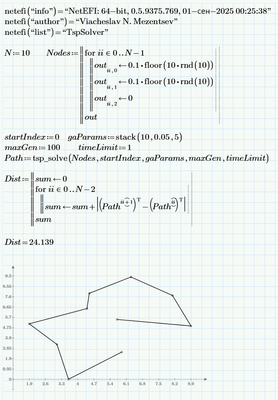

Made in 1.5 hours using AI.
tsp_solve Function Overview
I've created (Gemini) a powerful new function, tsp_solve, that integrates a Genetic Algorithm directly into Mathcad to find a near-optimal solution for the Traveling Salesperson Problem (TSP) in 3D Euclidean space.
This function returns the entire optimized route as a matrix, allowing you to visualize the path, calculate open or closed loop distances, and perform further analysis right inside your worksheet.
Function Signature:
tsp_solve(coords, startIndex, gaParams, generations, timeLimit)
Parameters:
  • coords: An N x 3 matrix where each row represents the (X, Y, Z) coordinates of a city or point.
  • startIndex: The 0-based index of the city (row in the coords matrix) that should be the starting point of the returned route.
  • gaParams: A 3x1 vector containing the core parameters for the genetic algorithm:
    • gaParams[0,0]: Population Size (e.g., 50) - The number of routes in each generation.
    • gaParams[1,0]: Mutation Rate (e.g., 0.02) - The probability (0 to 1) that a city in a route will be swapped.
    • gaParams[2,0]: Elitism Count (e.g., 5) - The number of best routes to carry over to the next generation unchanged.
  • generations: The maximum number of generations the algorithm will run before stopping (e.g., 1000).
  • timeLimit: A time limit in seconds that also serves as a termination condition (e.g., 10).
The algorithm will stop when either the generations count or the timeLimit is reached. It is also fully responsive and can be interrupted at any time by pressing the Esc key.
Return Value:
The function returns an N x 3 matrix with the same dimensions as the input coords matrix, but with the rows reordered to reflect the optimal path found by the algorithm. The first row of the output matrix will always correspond to the city specified by startIndex.

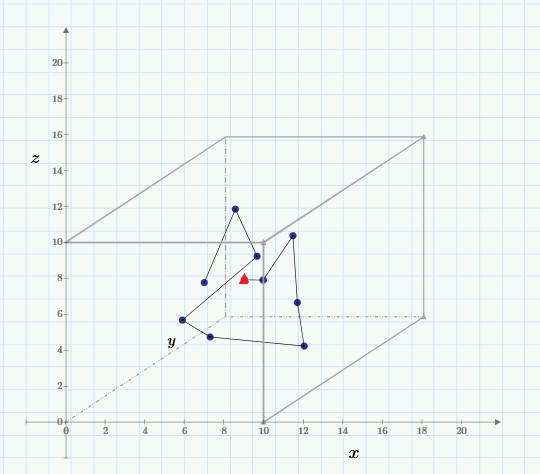

I've produced a 3D version of the original problem in Express. (my first attempt at including a 3D graph was a failure!).    More effort required!
Alan
Now managed to produce a simplistic 3D graph
