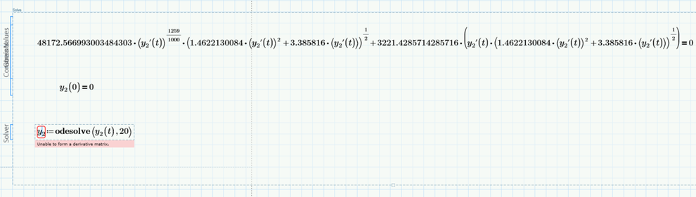

Hello, Expert guys in this community.
Recently I have received help to solve the problems in using Mathcad Prime 9.0. Appreciate it.
However, since I am just beginner level guy, I am having difficults with ODE solutions.
(In addition, if you can solve those equations with AdamsBDF, then pleas add it)
Please check attached worksheet files.
Your help will be very much appreciated.
Thanks!!

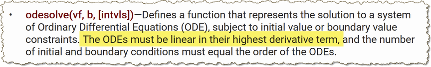

As I had written, it may not be a bug in case of the ODE you provided as the help clearly states that you can only solve ODEs which are linear in the highest order derivative which is not the case in your ODE.
https://support.ptc.com/help/mathcad/r9.0/en/#page/PTC_Mathcad_Help/ode_function.html

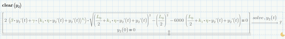

I may be wrong and maybe others have some idea to come up with a solution, but I think that unless the symbolic "solve" shown above would finally finish its calculation (I cancelled the operation as it took too long for me) I fear that Prime simply is not able and capable enough to solve your equation 😞
The stand alone solvers like AdamsBDF won't help either as they would require you to explicitly solve the ODE for y2'(t)=....

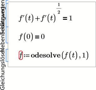

The error in the OP's sheet may not be called a bug, though, as the help states that odesolve would only solve ODE's which are linear in their highest derivative term which is not the case with the given ODE.
But I think we have already seen ODEs solved correctly which also were not linear wrt the highest derivative - but then I may be wrong, not sure.
As Odesolve fails with an ODE like
but the new symbolic ODE solver succeeds
I gave the ODE in Method1 a try
But the calculation seemed not to finish in finite time, so I had to cancel it.
Yes indeed,,,,I had tried the same way which you showed above....but it seems like a lot of caculation needed (so much computing power required)....so  I stopped it.
