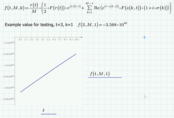

You can't numerically evaluate a function definition, so you must delete the equal sign after the definition of function f.
But there are a couple of other errors, too.
You define r as a function of t and so whenever you use r later, you have to type r(t) and not just r. Same applies to function theta(k).
Therefore your function s(theta) must be a function s(k,t) because its definition uses r(t) and theta(k) and whenever you use  s later you have to type s(k,t).
At the end you would have a function f dependent on t, M and and so far undefined value k.
I changed the definitions accordingly but am pretty sure that the result is not what you intended

It's not computing the correct answer. It's supposed to numerically invert a Laplace transform.

Yes, thought it would not be the result you expected.
I just fixed the syntax, the Mathcad errors concerning your usage of functions, etc., but not the semantics.

I couldn't understand the Mathematica syntax in the article you quote. Found another article by the same author and came up with this.
Prime 4 file attached.
LucMeekes
(To:LucMeekes)
Updated to include the Euler and Gaver-Stehlfest algorithms as well.
