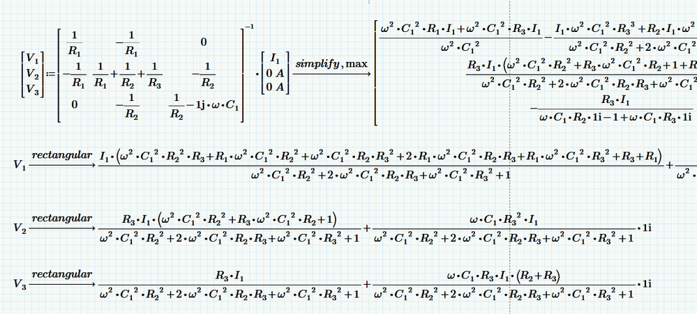

I wanted to create the Y BUS matrix from Netlist and solve that to get currents and voltages of each node.
For this i need to know how to solve the AX=B in matrix format, if all matrices(A,X and B) having variables only,
I want X in terms of Varibales(eqn)

you just use:-
Regards
Terry

You just use:-
Cheers
Terry

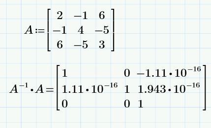

The inverse of a matrix times the matrix is the identity matrix (all zeros except diagonals being one)
Cheers Terry

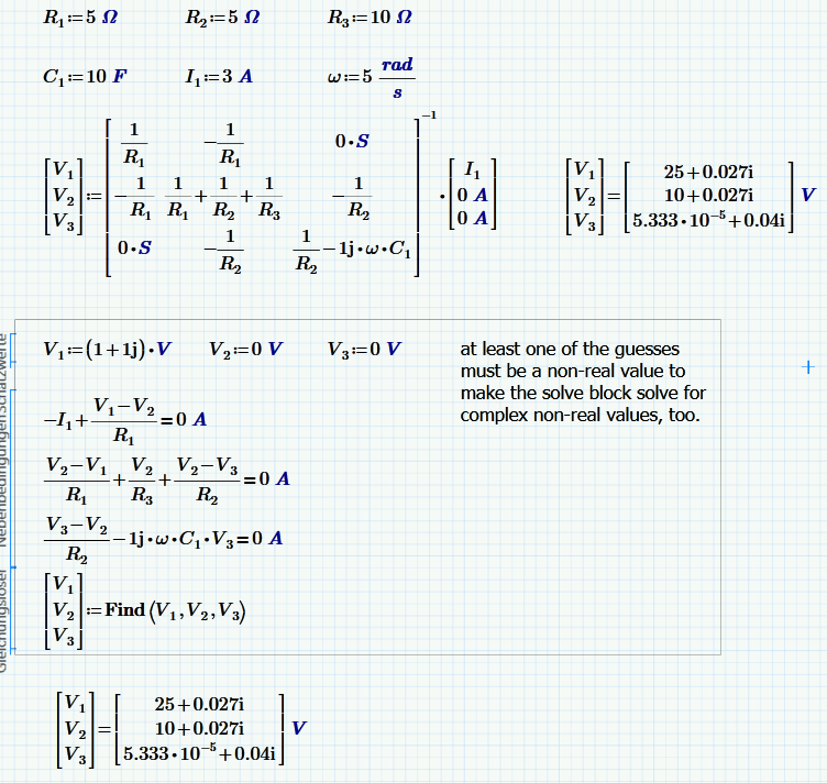

Do you really need a general symbolic solution? It looks a bit uncomfortable:
Wouldn't do a numerical solution do the job good enough?
You may either use the matrix approach or a solve block with the original node equations.
