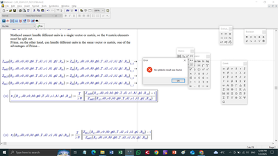

@LucMeekes  Thank you for the guidance, but even when used in Matchcad 15, the attached file, after being proceeded, also has no solution:
So, as far as I got from the Maple benefit's description, the possible way to solve my equations is to get used to Maple

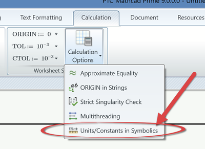

It may help to omit the units when using symbolic calculations.
If you use units with symbolic calculations, it may help to turn on this option and let the sheet recalculate:
I also noticed that in your definition of matrix Z none of the units are labelled as being a unit (bold blue). This may make the symbolics think that  variable W and unit W are two different variables, which sure can blow up the result.

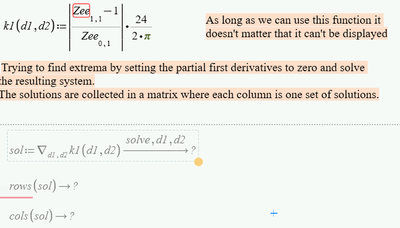

Attached is what I had in mind when I wrote about omitting the units. Its also not necessary to introduce new variables A, B, C ... - just use th original names. Actually your 'variable' A is not a variable, but the unit Ampere! You can tell as its displayed bold and blue.
Additionally you don't need to evaluate each expression symbolically. Don't mind the red errors - they stem from the numeric engine complaining that variables are not numerically defined and this does not interfere with the symbolic calculations later.
In the attached sheet I used the symbolic evaluation only when I defined function k1(d1,d2). That's necessary as otherwise we would have to define all variables which depend on d1 and d2 as functions in these two variables.
At the end I try to solve the system we get when we set both partial derivatives of k1 to zero.
I could not wait for the calculation to finish, so I saved the file and cancelled the calculations. Maybe you have more patience and luck. But I fear that Prime will not be able to come up with a solution - not sure, though.
I must confess that I am not very confident that you will be able to come up with a genereic symbolic solution for the maximum of k1 but I'd be happy to be proven wrong...

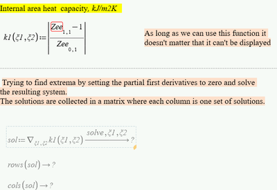

I understand Prime doesn't perform well at finding extremum solutions to matrix Math. I'm also still waiting for my  modified equation
to be resolved, but it seems that Mathcad won't be able to do it, or smth like this..🤔

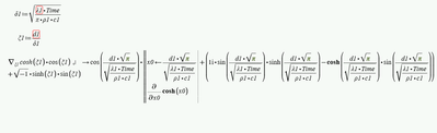

PS  I tried to find "simplier" equation symbolically  - d1 from the equation, but unsuccsefully...
Even when I substitute dzetta 1 and dzetta 2 as variables the picture still the same...
but, when I tried to find the derivative of simpler equation z11 it worked. And it pretty good, meanwhile...

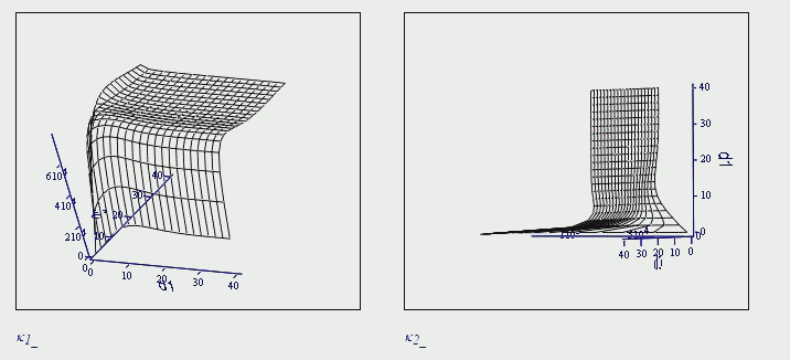

Mathcad (11) takes too long to write out the expressions for k1 and k2. I guess Prime will not be able to do that either, let alone determine their derivatives. But it is possible to create 3D plots of the expressions:
The units on the d0 and d1 axes are cm.

@LucMeekes  It looks pretty good, but I cannot understand the "plateau" region at the surface.
As I got, k1 directly depends on the layer variable parameters, their widths—d1 and d2, respectively.
Nevertheless thank you for your attention and assistance.
