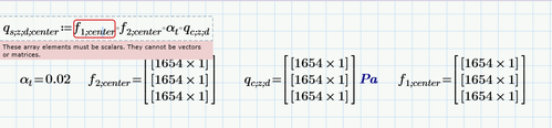

Hi there
I have a problem with this function . The issue is R is a cumulative value so the R2=R0+R1>
R3= R0+R1+R2 and so on... I wanted to implement that in this function but an error ( must be a vector ) shows
Is there a way to fix this or to write it differently
The sheet is attached prime 11

(To:YA_10963798)
@YA_10963798 wrote:
Like this you mean
The last R must be below and after (outside of)  the for-loop!

(To:YA_10963798)
dz, sigma, gamma are NOT nested vectors, so you should not treat them as such.
Also the stacking of M0 in front of M has to be done for every vector inside the vector M and not for M itself.
Here is a proposal for a modified function f2 which does not need the cyclef2.
It works with a normal vector M as before but also with a nested vector M.
Note that I used variables M and MM and also R and RR ! The names do not matter, but they must be different.

(To:YA_10963798)
@YA_10963798 wrote:
Thank you Werner
By the two expression I meant ( must by vector - must be scalar ) I always get such error
The problem is that you heavily work using nested vectors.
When you write  f1*f2*q  you get an error because in Mathematics multiplication is only defined for scalars
or for equal size vectors containing scalars (dot product, not to mention the vector cross product)
or for matrices (of scalars!!) where the column number of the first matrix matches the row number of the second
or for scalars times a matrix (of scalars!!)
But multiplication is NOT defined for any other odd nested data structure like nested vectors.
As soon as Prime encounters a multiplication with a matrix and the elements of the matrix are not simple scalars, the corresponding error message is displayed.
As there is no "official" math definiton how such unicorns should be 'multiplied', you must tell Prime in detail what you want to be done with such a data structure.
@StuartBruff  would probably write a generic multiplication function here that recursively digs into the data structure until it encounters scalars and can then multiply them 🙂
And his version most likely would be more elegant than my quick attempt below and maybe would even work in Express.
Of course you could also use such a utility function in your case.
As its written for just two factors you could do it that way
Or write a utility function which handles three factors
