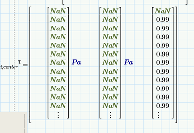

Ok But why if no error occurs , the results will be all (NAN)
What does that imply ?
(To:YA_10963798)
Can't comment on the values (NaN) and resulting data structure without seeing your actual data.
Maybe you can set up a simplified demo sheet with smaller vectors (and simpler variable names 🙂 ) which still shows the problems you encounter.
YA_10963798
(To:Werner_E)
I used the last sheet you sent and I just changed the first value of M to NaN , then I  all got f2 = NaN
I guess because f1 has NaN , in my sheet I calculate f1  and q first and they have NaN in the first row
and then I calculated f2 and M which they both have q in their functions .....but the results were all NaN
(To:YA_10963798)
Again, I can't comment on this without seeing the actual data and calcs you are doing.
All I can say that all four methods I had shown work OK even when the first element in each vector is a NaN
YA_10963798
(To:Werner_E)
I attached the sheet .  I tried to do exactly what you suggest but say in my original sheet when I don't add the vector I got all the results NaN in the two first rows and strang number in the third .
When I do it like yours I get an error
Can you help me please?
Yusra
