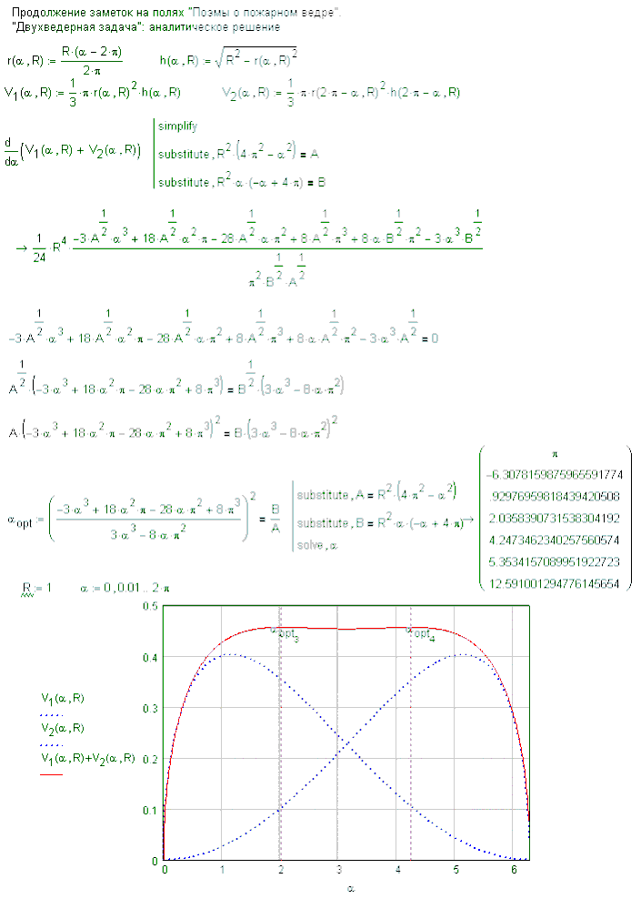

I have got the solution for the V function, but I cannot have got the solution for the V2 function!
Help please!
The Mathcad Prime 5 sheet in attach!
The problem.
We take a round workpiece and cut a sector out of it.
We then fold the cone from the workpiece.
The question is what is value of the cutting angle at which the volume of the cone will be maximum.
I solved the problem with one cone analytically, but I cannot solve it analytically for two cones!

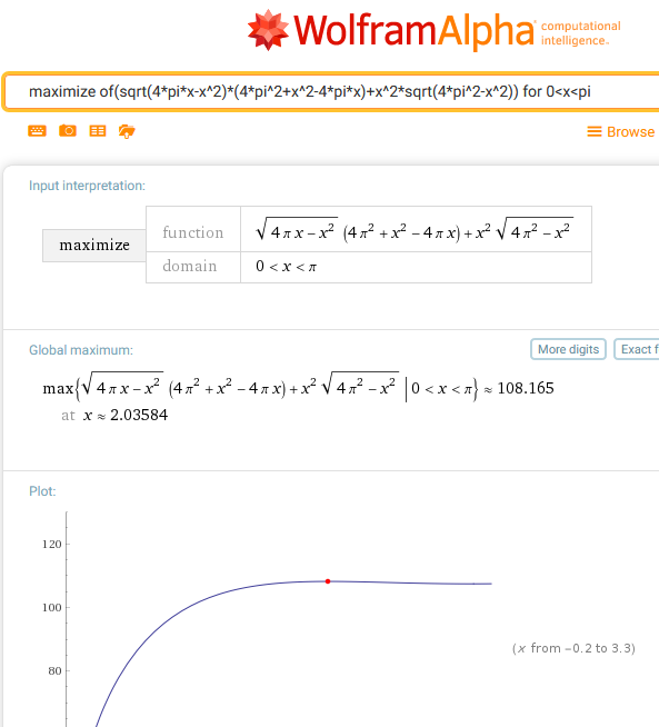

Even Wolfram returns a numeric result only (apart from local minimum pi) - at least with just standard computation time:
link to uncle wolfram

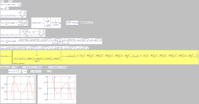

I find old solution from my coauthor Victor Korobov - only Mathcad 11!
Can you do it in Mathcad 15?

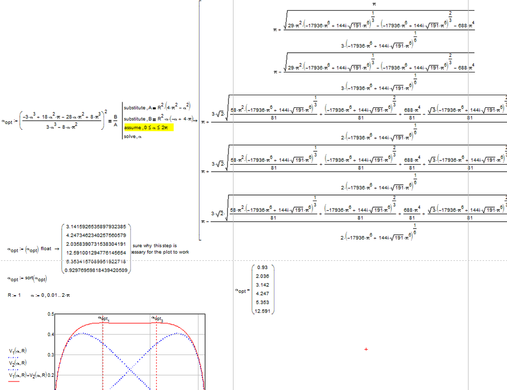

Here you are. A simple assume statement does the trick and, Heureka!, you also get the symbolic solution!!!
The assume statement itself is ignored (we also get solutions greater than 2 pi) and there is a somewhat strange behavior of the result when it comes to plotting (using the values for the vertical markers) which makes necessary a redefinition of alpha.opt which I don't understand.
