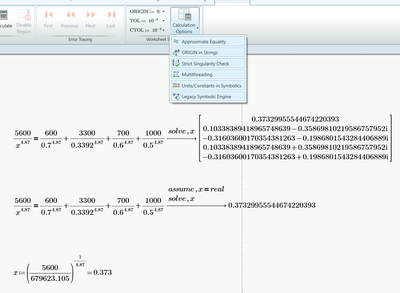

Can someone tell me why Mathcad isn't able to solve this simple variable? This command works everytime but with these types of equation it doesn't:
I have tried other commands but it still doesn't work:
The solution is quite simple, but I would like it to do it automatically:
Can somebody help me? Sorry if there are mistakes in my english. Thank you.

Hmm, one more example of  the "new"  symbolic engine which was introduced with Prime 6 having quite some flaws and being inferior compared to the old one (muPad), which in turn was far away from being perfect or even competitive with Maple or Mathematica.
You may consider reporting this bug to PTC support.

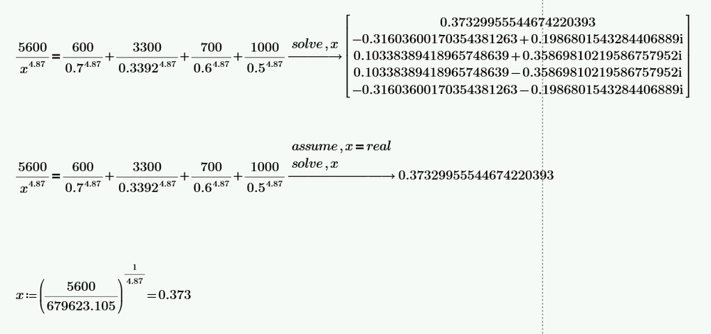

Prime 6 is the only version where we still could switch back to the old symbolic engine which finds the solution(s) with ease:
EDIT: I notice that I have a typo and the 5000 should be 5600

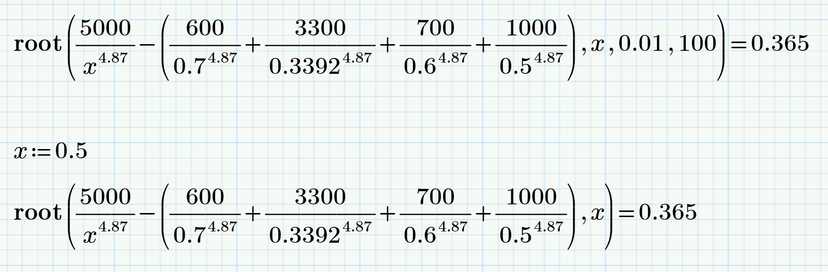

But it seems that you are just looking for a numeric result anyway, so why not use one of Primes numeric methods for solving an equation.
Either an ugly looking solve block or the "root" command in one of its two flavors:

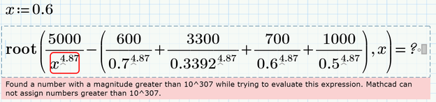

BTW, a question to the community: Can anyone explain this error message which I get with a guess value larger than 0.5?
Looks like the algorithm tries values for x smaller than 10^-62, but why would he do so?

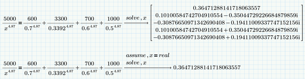

1. What version of the program are you using?
2. Here is the result in version 7.0:

I can confirm that the bug is present in P6 with the new symbolic engine. But according to Vladimir's post its obviously  a bug which PTC already fixed.
In P6 you have the choice to switch back to the legacy engine but nonetheless I would recommend to use numeric methods for numeric results.
But you could use the symbolic engine that way
This works OK with the new engine in P6, too.

I tried changing the 'calculation options' and it worked. Thank you.
