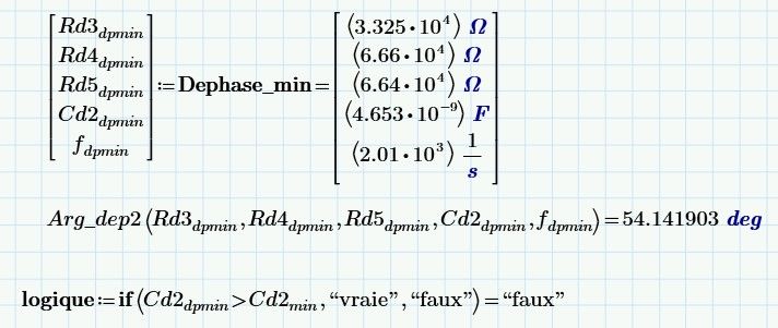

I tried to calculate minimal value of the complex argument of a Transfer function through minimize function inside a resolution bloc. Mathcad indicates that there are no solution found, try to modified initial values or TOL or CTOL, but it does not help.
I think that Mathcad does not find solution because the argument does not change, but manual calculation gives different values according constraints.
Could you please help me to understand why the Mathcad do not understand the constraints?

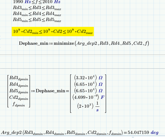

I am using Prime 9 so cannot save the file for you.  Will use pictures.  Enclosed Prime 9 file.
Prime works from left to right, top to bottom so definitions of variables need to be to left or above where they are used.
In the minimize function the first argument is a function name only.  arg function needs to be in definition of that function not in minimize function.
To be used as a constraint f must occur in the function so it varies in the solve block.

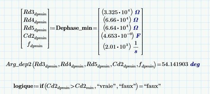

However, my need is the minimum argument value. In my case, the result is false because a constraint is not observed (Cd2).
From my file, could you explain me why this constraint is not respected ?

I tried the sheet in Prime 4,5,6 and 9 and experienced different behaviour in 4 & 5 compared to 6 & 9.
Changing TOL and CTOL does not have any effect in either version:
Older versions seem to not fully respect the constraints (probably because of the low values) which obviously was fixed in version 6 and above.
EDIT: @Christophe.fr
You can "weight" the constraints by multiplying the values with a large factor
This seems to have the desired effect in Prime 4, too:
You can play around and do similar (maybe with different factors) with the other constraints as well.

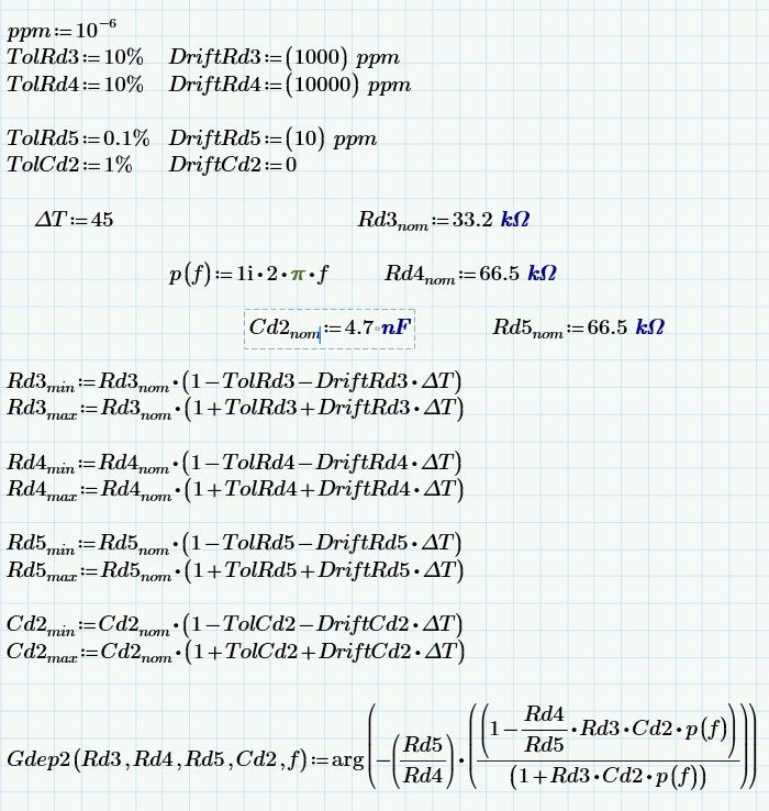

BTW, your constraint
does not have any effect at all - DeltaT will be 45 throughout as you had defined it.
What did you think this constraint would be good for?

Hi Christophe, Werner
I am suspicious of the minimize algorithm is not resolving correctly.
Two corners of the solution that meets the constraints as shown in the worksheet are at a lower value than the found solution.
