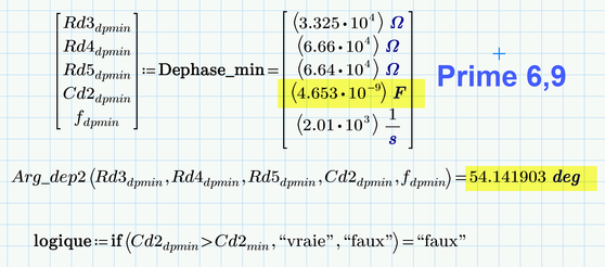

I tried to calculate minimal value of the complex argument of a Transfer function through minimize function inside a resolution bloc. Mathcad indicates that there are no solution found, try to modified initial values or TOL or CTOL, but it does not help.
I think that Mathcad does not find solution because the argument does not change, but manual calculation gives different values according constraints.
Could you please help me to understand why the Mathcad do not understand the constraints?

Calculations are 3.3x10^4 to 4.653x10^-9 this is a wide spread and lower than the TOL or tolerance setting..
TOL is set at 10^-3 in your sheet and this cannot handle the spread of data you need.
Set the value of TOL to 10^-7
Calculations will then be as expected

Hi Terry,
I replied too fast on friday, I was too happy to have a solution or too hurried to start week end...
But this morning I changed TOL and CTOL without change.
Could you explain please ?

I tried the sheet in Prime 4,5,6 and 9 and experienced different behaviour in 4 & 5 compared to 6 & 9.
Changing TOL and CTOL does not have any effect in either version:
Older versions seem to not fully respect the constraints (probably because of the low values) which obviously was fixed in version 6 and above.

You can "weight" the constraints by multiplying the values with a large factor
This seems to have the desired effect in Prime 4, too:
You can play around and do similar (maybe with different factors) with the other constraints as well.

Hi Christophe, Werner
I am suspicious of the minimize algorithm is not resolving correctly.
Two corners of the solution that meets the constraints as shown in the worksheet are at a lower value than the found solution.
Cheers
Terry
Minimize is also dependent on the guess values - it won't be able to find the absolute minimum, just a local one.
So changing the guesses might give a better result. The solve block seems to be VERY sensible wrt the guess values and tends to fail if a guess is even changed only slightly.
Furthermore "minimize" minimizes the "errors" and here they seems to have changed the way the errors are seen with respect to the constraints when going from Prime 5 to version 6.
