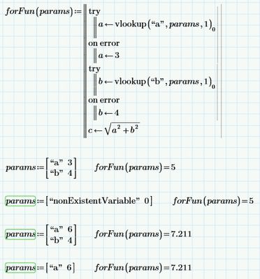

Sorry to resurrect an old post, but this is the first result on Google for the query "mathcad optional parameters" and I am hoping it will be helpful to someone.
One solution would be to pass an array/matrix as the only parameter to the function, then within the function use the try/on error statement to check if your optional parameter is defined or if you need to give it a default value.  This could get very verbose very quickly if you have a lot of optional parameters, but should work in Mathcad 15 as well as Mathcad Prime Alpha3 or newer.
