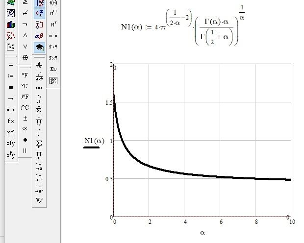

-MFra-
(To:Anousheh)
M15,

I have only Express, so the  G function is not available to me, but this is how to plot inside mathcad.  N2 function plots just fine.
