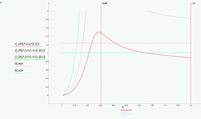

Plotting failed. Replace complex values and NaN by real numbers.

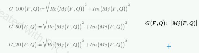

My costumer have the problem of the mathcad, and I don't know how to solve it.

I agree with Luc and Werner (below) that Prime will run this sheet.
The one you posted had obviously been converted from Mathcad 15 (all the red arrows are a giveaway.)  I have Prime Express, and version 6.0 had no trouble until I got to the definitions of the gain; then I was told that "Im" and "Re" are premium functions.  I was able to sneak around this,
and get the same plot as Werner

For  whatever reason, the plot has numbers in the units placeholder locations.  Try removing those, leaving only blank placeholders.

I see the error when I open the file (last state before saving) but when I let the sheet recalculate I get a plot without any errors. I tried with Prime 6 and Prime 5 and both worked OK.

I try to recalculate the sheet, but it's still have the error....
