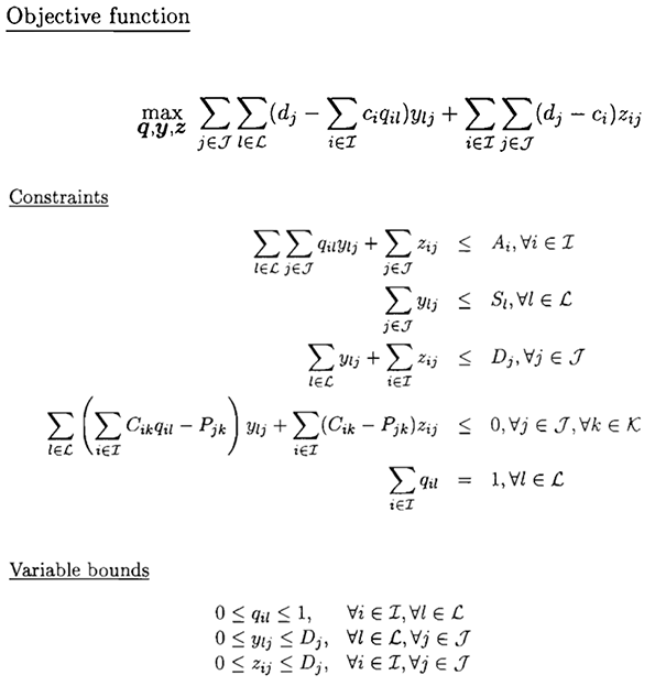

I have the following task to solve and i dont know how to do it. I guess its just possible with programming well maybe someone can help me.
In the attached sheet i have a pooling problema optimization.
Could anybody help me to find coding to solve pooling problem optimization using Mathcad?

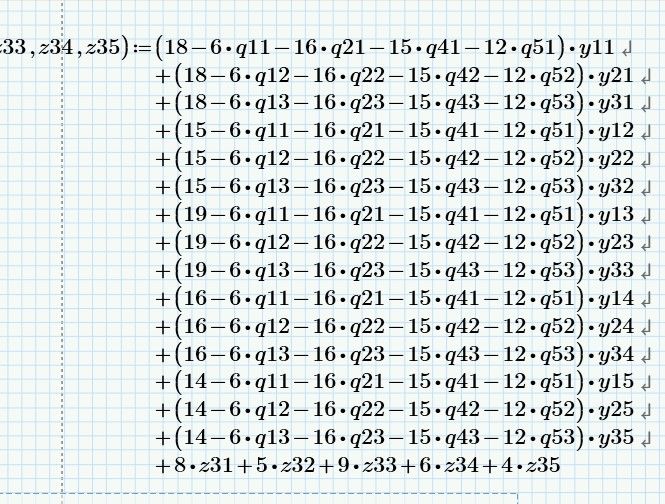

Enclosed is a pdf printed in A4 landscape.
Some of the maths spills over the page width and this cannot be printed in Prime,
These wider bits are in the three pictures below

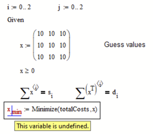

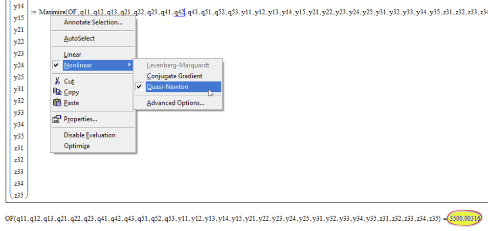

Hello friends,
I can´t get the value 3500 wiith MC15. Maybe I have to modified initial values or TOL or CTOL?
As you can see in the picture below, I can´t get the value 3500 wiith MC15.
I also want to ask you, if it is possible to simplify the problem using summations as this class of problems is defined? As in the image presented.
Thanks in advance for any help.
Best Regards,
CarlosRomero.
I expect the equations still have an error if not getting the 3500, so need to check them.
Cheers
Terry

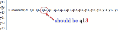

Like Terry I also can imagine that you still have typos in your sheet. Sure not easy to spot (the double occurrence of q12 was easier to spot) and you would have to very carefully compare Terry's pdf of Prime and your Mathcad sheet.

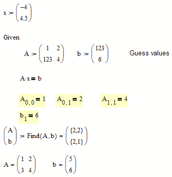

In the example in the other thread with
the approach using ranges i and j does not work
If trace back that error you land a t the i in the sum at the column selector <i>.
Thats the reason I had to define auxiliary functions
to be able to formulate the constraints
Furthermore it looks to me (had not looked in detail at the example in the pdf you attached) that in your new example some values in the matrices are already predefined (maybe zero, as they do not occur in the schematics) and must not be changed and some are to be looked for. This also can be tricky.

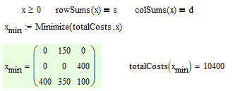

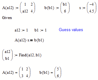

While its possible to let a solve block find whole matrices or vectors if you provide appropriate guess values like in
it can be tricky if just part of the matrices are unknowns and it might be necessary to define some of the matrices as functions similar as seen in this simple example
Another approach which avoids defining the matrices as function would be to add additional constraints for the matrix elements which should be constant
In case of a maximisation task it may be necessary to "weight" those constraints which could be done by using something like

First step would be to define the vectors and matrices d,c,A,S,D,C and P which are not given explicitly in the pdf you posted and may just be deducted from the given constraints like
Next step is to determine what the dimensions of the vectors/matrices q (5x3), y (3x5) and z (5x5) would be and which elements of these vectors must be set to constant zero. E.g. q31, q32 and q33 must be constant zero because there is no connection from feed #3 to any of the three pools. Likewise only row #3 in z is non-zero because feed #3 is the only feed with direct connections to the five products.
And now you would have to either define those three marices q,y,z either as fnuctions as shown in the example above or add the zero values as additional constraints.
Now try to formulate the OF and the constraints and limit using the summation operator similar to the formulas given in the pdf - you may have to make use of auxiliary functions as described above and shown in the other thread.

Additional remarks according the OF not yielding 3500:
Hi
Werner, Carlos
Spotted the constraints should be 200 for these values where sheet has 100.

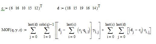

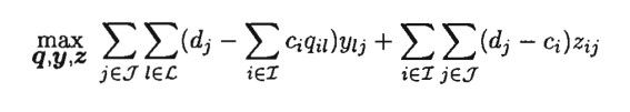

Have converted the optimization equation to the matrix form using summations as per the document. Now going to do the constraint equations in the same way I hope.
Excellent, Terry.
It´s more clear.
CR.
