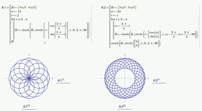

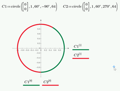

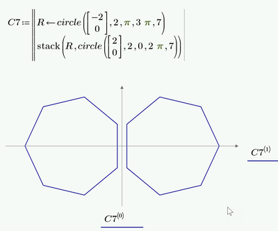

Here is a circle function I often use when I have to draw a circle.
You may use it to draw partial circles
to draw regular polygons
or to play around and create mandala like pics
Prime 9 worksheet attached

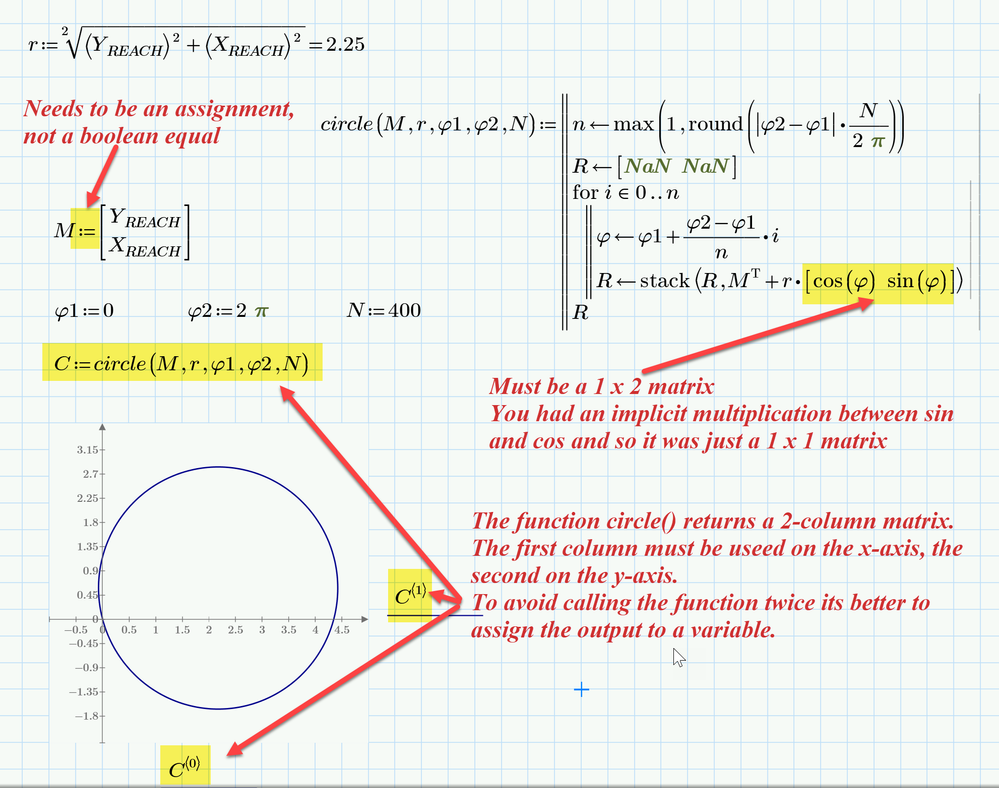

Sorry.... I was not clear.  I mean that one point on the circle will be at (0,0) with a center in Quadrant 1 at a point (x,y).
Yes, I had already suspected that and therefore suggested calculating the radius (as the distance between the two points, with Pythagoras, r= sqrt(x^2+y^2)) and then using the method already suggested or the function I posted to draw the circle.
Thank you!  I will try to plug in your equations.  I have Prime 8.0 so I could not use it directly.

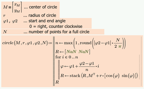

This this bit of programming [NaN NaN} ?  Looks like the first trial bombed.  I am a novice at programming.  See attached.
ttokoro
20-Turquoise
(To:Snowshoe_Bob)
[NaN NaN] makes pen off for the plot line.
Thanks!!
Hope this helps:
BTW, you sure can use 400 points to make the circle but you would be surprised that even much less points make up a quite good representation of a circle as well.
Thank you!  It works!

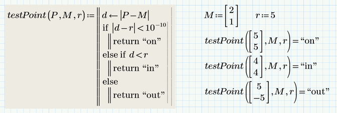

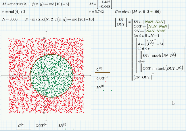

In relationship the above math, is there a boolean or math routine to determine if a X-Y point is inside or outside the circle?  Can suggest a tack to take to solve this problem?
@Snowshoe_Bob wrote:
Werner,
Update:  If I resolve the point as a radius, then compare that radius to the radius of the circle, the problem is solved I believe.
Which problem?
Not sure what the problem is!?  A point is inside the circle if its distance from the circle center is less than the circle radius.
You may use a test function like this:
Playing around ...
Worksheet in Prime 6 format attached
I like what you did...  I would have handled it a bit more rudimentary.   But your solution is best.

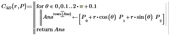

For those limited to express, here is a set of functions to draw shapes:
And you can stack the result to create complex shapes, such as the CE mark:
Thanks!
This looks very handy!

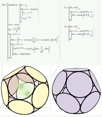

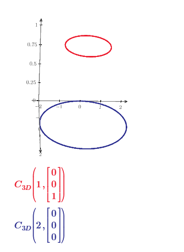

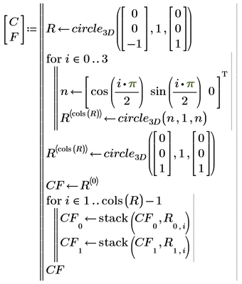

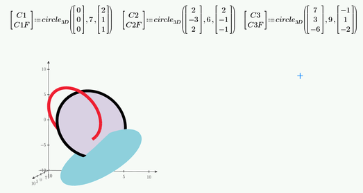

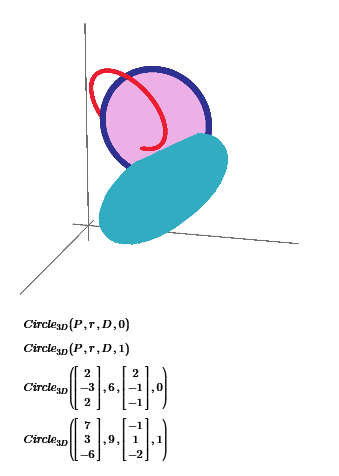

Nice, but why only circles parallel to the xy-plane?
(To:Werner_E)
Playing around with the inscribed circles of the surfaces of a dodecahedron
Nice!  Thank you.  Will work for future programming..

Thanks show us not x-y plane plot. I try it.
(To:ttokoro)
ttokoro
20-Turquoise
(To:Werner_E)
