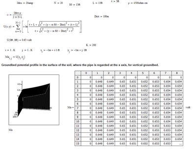

I have an issue plotting in Mathcad 15.
I am trying to plot a 3D surface, and I received a message that I have never seen before:
"Specified cast is not valid."
I do not know what that means and do not see the problem.
I could calculate the matrix that gets all the values for the surface calculation, but at the moment of plotting it, I receive that message.
Thank you in advance,
Rogelio

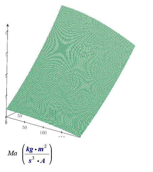

Hmm, this is what I see when I open your worksheet
No error message.
Here is the result when no lines were plotted but the contours filled and drawn
The error message you reported may be caused by some installation/software problem on your machine.
I have no idea if this could be of any help, but I resaved the sheet and attach it here. I also have removed the border around the plot because I remember that many people reported problems with 3D plots in MC15 when Windows 10 was brand new and one of the workaround suggested was to remove the border. Just a feeble attempt - if it does not help, then it should not hurt either 😉
Should have nothing to do with the plot failing, but I noticed that it looks like you are not aware that the default setting of ORIGIN is 0. This means that the first index in a vector or matrix is 0, not 1. Your ranges are defined to run from 1 up and the definition of your matrix ma uses these ranges. This means that the first row and first column (both have index number 0) never were assigned a value and so they default to zero. You can clearly see that in the display of Ma. I guess this wasn't done on purpose.
I was also surprised that in the defintion of x and y you are mixing meter and feet. Because the ranges start with one, the first value in x and y are -1meter+1feet = -0.605 m = -2.281 ft. Was this done on purpose?

Not sure if you saw that I had edited my reply and attached the resaved file with border around the plot removed. I guess that you encounter the same problem with that file, right.
I attach a new version of that file here. I changed the range definition and the definitions of x and y so they both run from 0 ft to 200 ft with a stepwidth of 1 ft.
You can see in the pic that this causes the vertical planes caused by the wrong zero values to go away
I also added another way to create that plot by using CreateMesh - it was necessary to define a unitless auxiliary function to do so.
But I have no idea if these change would affect the severe problem you encounter.

Regarding your questions: I use ORIGIN=1 most of the time, but when I sent you the file, I had to cut a bunch of stuff from the original one, which is about 13 pages long, and I cut the definition of ORIGIN when I did that.
Also, I sometimes have to use mixed units because the potentials that I calculate will go infinite if the calculations of the bottom part of the equation are zero. If I mix the units, that will not happen.
