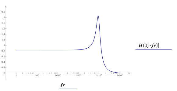

Hello all,
I think I am in the correct thread. I am having a similar problem. Essentially, I am trying to make a Bode plot on the last page of this MathCAD Prime 8 file.
Thank you in advance for any help with this issue.

I tend to disagree! This nearly five year old thread is not YOUR thread and this thread already was so often hijacked by people having various problems with plotting for different reasons. So its rather long and dealing with various different, unrelated problems which strongly diminishes the willingness to deal with it in more detail. Furthermore this thread is already closed / marked as "answered". So follow up posting sure don't get the same attention as a new opened thread will get.
So I can only suggest that you open a new thread with your question. You don't need to zip the worksheet to attach it.
I would also suggest that you clearly describe what kind of plot you would like to see because the way you had setup your plot sure can't result in a bode plot. The error message states that Prime (on contrary to real Mathcad) does not allow two arguments being ranges. Furthermore you just have nine values for "n" and four values for "exp" - so at the best your plot would consist of just 36 separate points!
BTW, I don't think that your problem is in any way related to the one of @Cornel which had to do with symbolic evaluations in this still open thread https://community.ptc.com/t5/Mathcad/Determinat-of-a-Matrix-Mathcad-Prime-8-Strange-Result/m-p/851428/highlight/true#M204835

(To:KAndersen)
See attached file.
(To:LucMeekes)
Using the quickplot feature (=not defining the frequency via "logspace" or "Decade", leaving "fr" undefined and setting the plot ranges in the plot itself by editing the first an last value at the x-axis) seems to provide a nicer output.
EDIT: Of course using your method you can get an equally smooth plot if you use more than just 10 points per decade. The benefit of using "logspace" or your "Decade" is sure having a better control over the output.

Thank you everyone!
@Werner_E @LucMeekes @Cornel
I am very grateful for the help. I used your suggestions and the plot coming along nicely.
