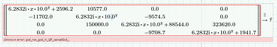

Hm...Werner, one of the problems here is related to what I posted already previous days about the inverse of a matrix and calculating the determinant:
CornelBejan_5-1674676492971.pngIt seems hard to believe that the above result is correct..
Maybe Werner can better explain the problems related to calculating the inverse of a matrix, and calculating the determinant..problems you encounter at least in Mathcad (Prime)...
