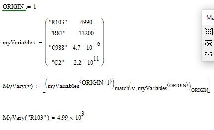

You can sort of do it like this:
Cheers
Terry
Forgot to show you can get myVariables direct from an Excel component.

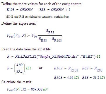

Apart from the fact that it is desirable to have a function that can define a worksheet variable, in order to drive that variable name from e.g. Excel, you must have a reference. At some point you need to decide which one of the many variable names that are defined in the Excel table will be used at which position in a Mathcad expression. So why not let the row index do that....
Then it might look like this:
 Also bear in mind that it's almost as difficult to bring units over from Excel to Mathcad

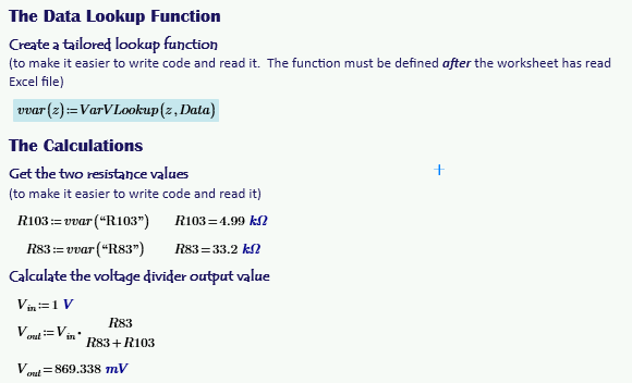

In the example below, I've created a tailored version of one of my lookup functions to make it easier to use.

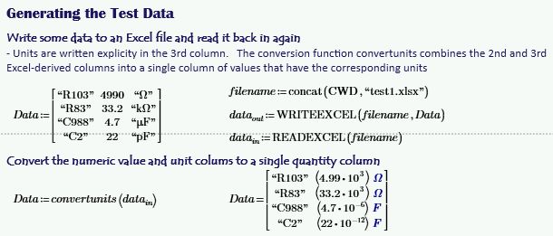

In the meantime, here's one way of tackling the problem:
