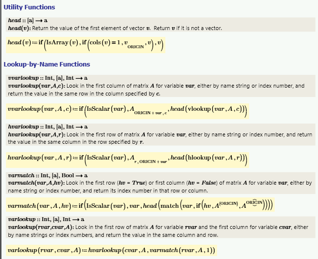

By way of contrition, I present a "simplified from a user perspective" use of my lookup-by-name function.  I've put all the lookup functions into an Area and the data generation into another Area (as it's not needed by the general user).
This, hopefully, shows how easy it could be to use the functions:
  • copy and paste (Argggghhh!) the first Area into a worksheet,
  • load and convert the Excel data,
  • create a tailored read function (if the user wants to, otherwise use one of the lookup functions directly or create a shorter alias for the needed one)
  • lookup the required variables
Cheers,
Stuart

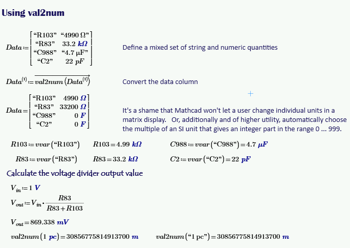

Got bored whilst working on something else, so threw together a val2num function in Mathcad Express.   It converts quantified strings to standard numeric quantities (for quantities that it knows about).  It's quite moody, though, and sulks if the user doesn't leave a space between the numeric value and the unit.
I'm working on making the function Potrzebie-aware.   Apparently, Proxima Centauri is 17739573709665 furshlugginer potrzebie away (plus or minus a page or two).

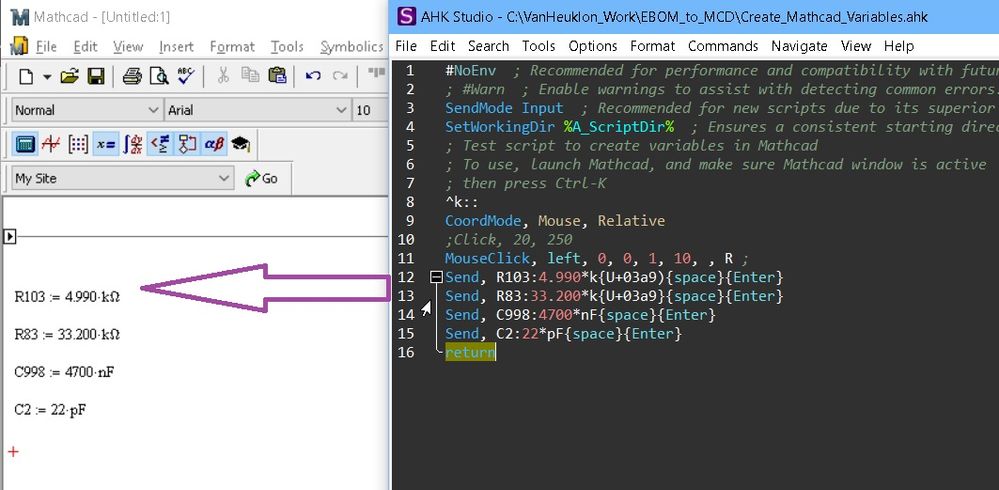

I think I found a solution to the second half of my problem... that of programmatically CREATING a variable in Mathcad: AutoHotKey (https://www.autohotkey.com/). The simple example below shows a program in AutoHotKey that creates 4 variable in Mathcad when Ctrl-K is pressed. I still have a lot to figure out with regard to opening a file and parsing it in AutoHotKey, but I am confident that it can be done. This might not be the most elegant solution but  I think it will accomplish my objective. Thanks again for the suggestions.
Good bit of research.
Visual Basic in Excel had a similar SendKeys method.
