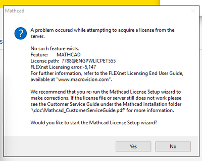

Can you still use Mathcad 14 or has it been phased out?
PTC does not sell and support any version of Mathcad or any version of Prime prior to Prime 7 (current version is Prime 9).
Reason is the symbolic engine embedded in those versions which is owned by MathWorks (known for of Matlab).
If you have a perpetual version of Mathcad 14 or Mathcad 15 you should still be able to use it.
If you need a license file for a new hardware, it was said by users in those forum that the usual ways to transfer the license online do not work anymore and you will have to contact PTC support. They should be able to help and send a license file which works for the new hardware.
thats the problem (licensing dramas our university is having when opening up mathcad 14.
IS that something that can be fixed? I think it will just be very beneficial for everyone if i continue to use MC14.
