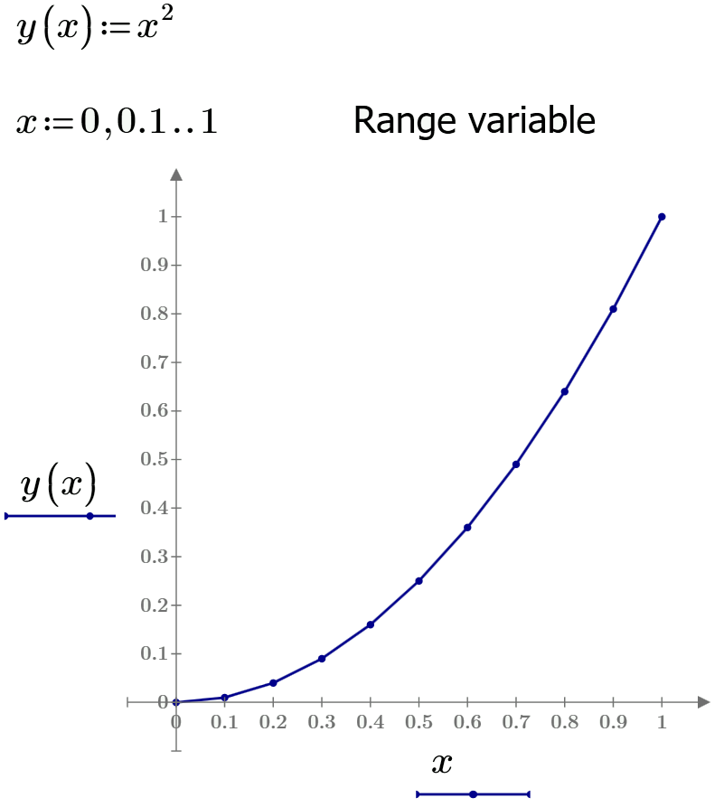

What is a Range variable?
This is a variable, without which it was impossible to do someone in old-old versions of Mathcad (Mathcad 4 I think but not Prime). There was no programming and technology for QuickPlot in this versions. Now, we have programming and technology of QuickPlon. But we continue to use the range variable according to habit, for convenience. But this sometimes creates some problems (one example here). The range variable is similar to the vector and some Mathcad users try to apply to the range variable tools intended purely for the vector.

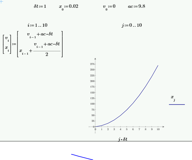

Can you show me one Mathcad sheet where we can not do anything without a range variable?
One little example:

Your vector variant still depends on a range (the for-loop!)
Basically a range can and should be used just for three different tasks:
1) index the elements of a matrix or vector
2) define a range for plotting
3) in a program in the definition of a loop

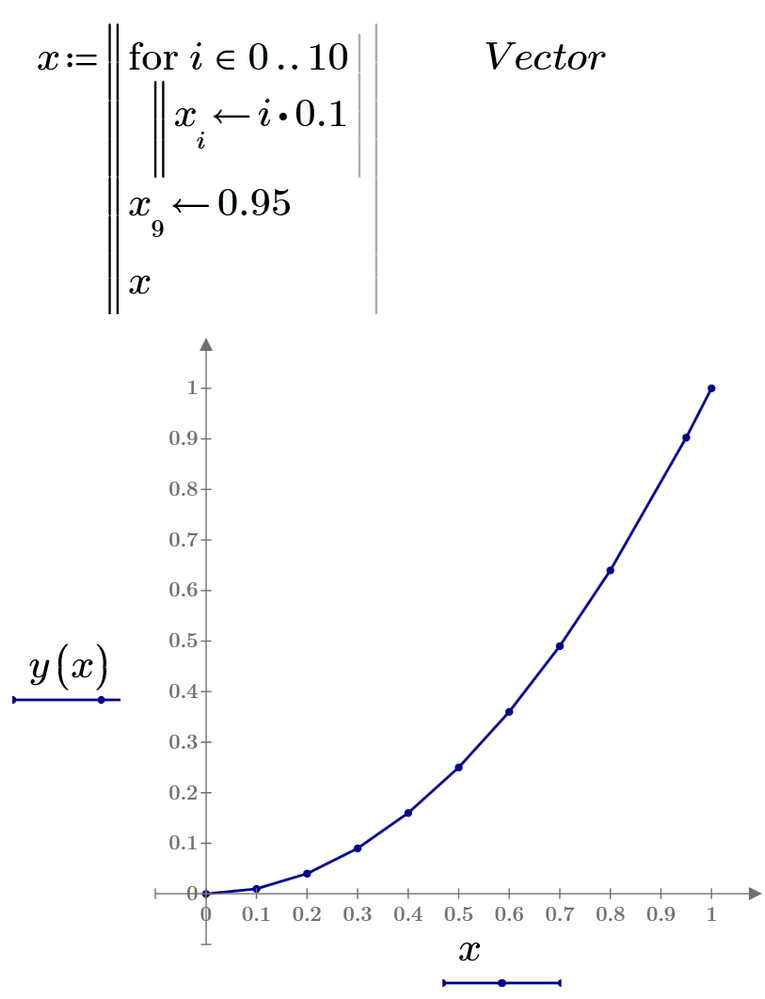

Sorry, it was not a Range Variable but the programming construction For. See please

It's no problem to do a For loop without using a range, because For works with vectors too:
However a range shows much more clearly what is going on.
So I guess the conclusion is: A range is not necessary, but while it's there it's better to use it (properly).

I believe that the matrix equation that uses the index and index -1 to develop the next value in the matrix would not work without a range variable index.  If i is a vector, how do you address the next location in the solution matrix?
I would be happy to be proven wrong.  Smiley Happy

Smells like challenge!
You mean something like this?
LM_20180906_NoRange.pngLuc
VERY NICE!
I stand proven wrong!  (I am a bit surprised that Express will allow recursion.)

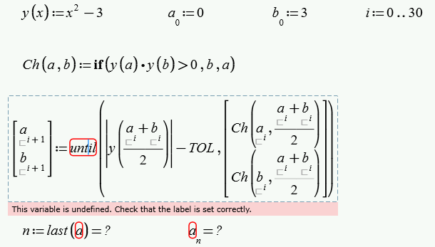

There was a function until in old version Mathcad and we was able to create loops without for and while operators!
while loops do not (necessarily) require a range variable.  Both while and until test conditions and so can be constructed without a counting index.

Valery,
Can you show a working example with the until() function?
(Proper usage of that function where it operates as specified...)
One picture from my old book - a bisection method of the root finding:
in Prime (the converting from Mathcad 15)
As it was explained to me until is the same as a while loop.  The until loop tests at the end of the loop and the while loop tests at the start; so the until loop will execute at least once
I think until works in Prime Express! While - not!

Thanks Valery!
I was able to recreate your example sheet in Mathcad 11 (needs to be set to 'backwards compatibility', otherwise I get an 'Obsolete function' message).
The function until should work in Prime Express because it's a function AND it is not considered 'Premium'.
In contrast, 'while' is a programming construct, not a function, and programming is considered a Premium feature, so not available in Express.
However, I cannot show Prime (4) Express functionality using until, because I get the error message that 'until' is an unknown variable....
Can you open in Prime (4) Express the file in attach?

Valery,
I can open the file in Prime Express 4, no problem. After opening it shows the (saved) results. But when I recalculate:
So it's NOT because it's a 'Premium' function, but it's simply unknown. Smiley Mad
Fred, do you get the same?
@LucMeekes wrote:
Valery,
Yes.  I'm fairly sure that "until" had disappeared from Mathcad some time before version 15.
LucMeekes
(To:Fred_Kohlhepp)
The function 'until()' was declared obsolete in Mathcad 11. However if you set 'backwards compatibilty' it is still usable.
I understand from Valery's contribution that it (again) works as intended in Mathcad 15 and in Prime (but not Express).

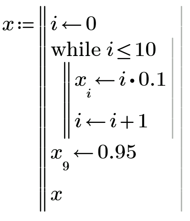

We use the until loop only in one case, when the boolean variable that controls the loop takes value only after the first execution of the loop body. This cycle is not present in Mathcad and we must artificially set the value of this variable before entering the while loop.
But the universal loop in Mathcad is
