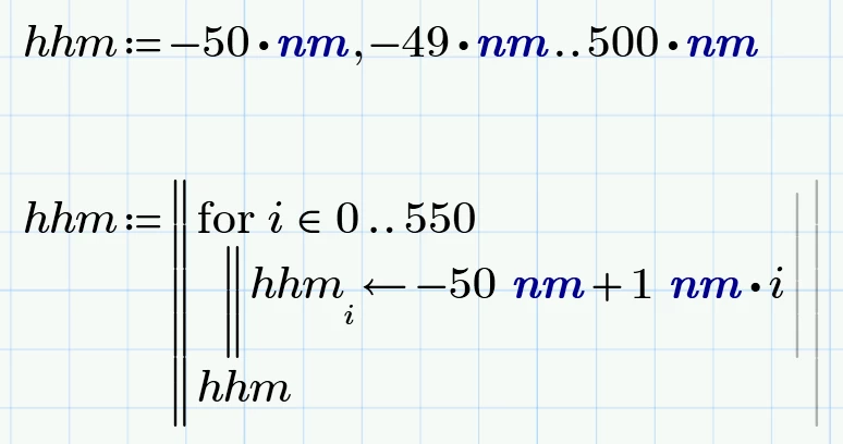

I have a problem with importing my MathCad results into the Excel component. I have two variables and I want their summation (one a range hhm,  and the other one is a scalar hm). I can get the summation outside of the Excel component, but it's not working inside the Excel component.
Any tip is really appreciated. Thank you! Helya

    Best answer by ValeryOchkov
    Use please not a Range variable but a Vector!
    September 13, 2018

    September 13, 2018
    See please also
    Range variable - atavism
