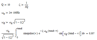

The expression inside the "max" function in your program yields just one single scalar value (not a vector) - so what do you expect that "max" should do?

In your sheet you try to take the maximum of a single scalar value.
For every of your  400 frequencies (in the example below I had chosen 100 Hz) the expression in your max function (basically a definite integral) would yield just one single scalar value.
max would normally work on a vector of values but if you simply provide a single scalar, max would return juts that value.
Here is what you calculate 400 times and this is what you final plot would consist of:

In your program the upper integral limit is constant t.end.
If you change it to variable "t" (which is defines outside of the program in front) is makes sense to use "max". Of course you would have to vectorize the expression.
It took a long time to calculate (vector t has 4096 elements) as the integral had to be calculated 1638400 times.

I notice that in your program you have two times the expression (tend - tau) but in your function QQ it reads (t-tau).
Furthermore it looks like Mathcad has problems with the vectorization of the integral. Putting the integral in an auxiliary function helps:

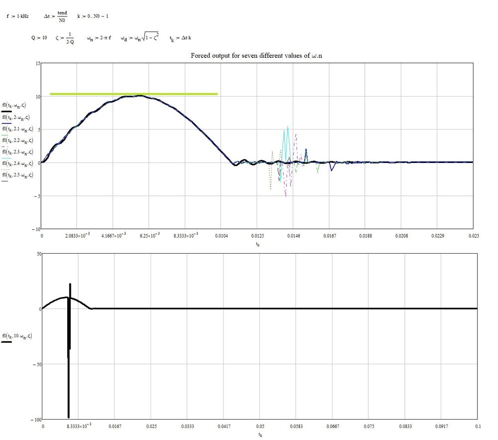

It is clear that the system in question is a linear and stationary system of an unknown nature. The analytical relationship between the response and the excitement of a linear and stationary system, whose impulsive response is known, is given by the convolution between the two and constitutes the forced response of the system. See image. What leaves me a little perplexed is that you ask the simultaneous trend of the maximum value of the response to the variation of time and frequency (it can be seen from the loop with index i) which does not seem correct to me. Since the system is linear and stationary, the Laplace transform is commonly used, and thanks to the Borel theorem, from this, with an inverse Laplace transform calculation, one gets the forced response as a function of time. For the analysis in the frequency domain, just put, then, s = jω into the transfer function and plot the Bode diagrams. Knowing the forced response of the system,  It is possible to determine the peak of the forced response and then to determine its trend as the frequency changes.
This, however, requires many laborious and difficult calculations

The system is a simple 1DoF Spring-mass of natural frequency fn (or wn). This system will response to an input (half-sine input) and I am calculating the shock response spectrum SRS. For each natural frequency in a given range, calculate the time response (using convolution) and extract the max response that's the time part. One end up with a pair of data (fn,max acceleration). To qupte from your response. ".. It is possible to determine the peak of the forced response and then to determine its trend as the frequency changes". This is what I am doing
Still haven;t figure out why I get spikes in the response

Knowing the forced response, then the graphs of the same can be traced for different values of the pulsation. The graph shows that the maximum amplitude is constant with the variation of omega. As you can see, the graph in logarithmic scale, varies with the variation of N0, while the answer is unchanged.
