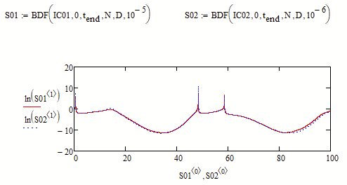

Don't know why but decreasing the tolerance argument from 10^-5  to 10^-6 makes BDF work (Radau still would fail, though).
That worked. I thought I tried this, but evidently not. I did have to keep decreasing the tolerance for larger amplitudes (epsilon) but it worked for the largest values.

I noticed that you can also omit that sixth optional tolerance parameter and BDF would work OK.

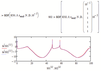

This parameter can also be a vector and you can specify a different tolerance for each of the variables. It seems that its the first variable which needs the smaller tolerance value:
