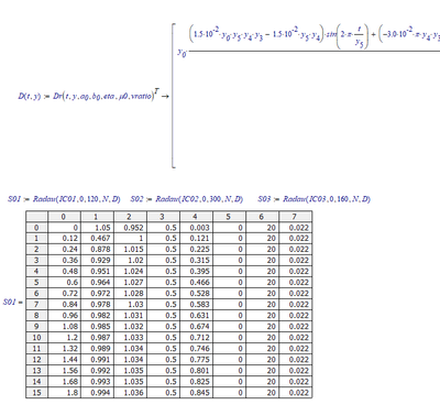

What does this mean? I could not find it in the list of error messages. The attached program was working until I set a_1, b_1 and d_1 = 0.
April 30, 2021
Can you save the file as a Mathcad 11 .mcd file and attach?
April 30, 2021
Saved as MC11. Sorry, Luc, I forgot that you are even further behind on versions that I am. Thanks for taking a look.
April 30, 2021

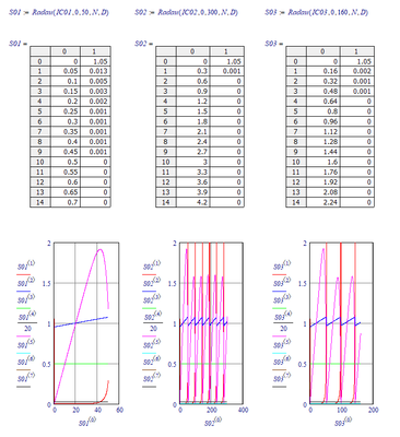

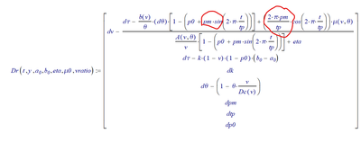

After some fumbling this works:
Note that Mathcad 11's Radau only knows 5 parameters, not 6.
