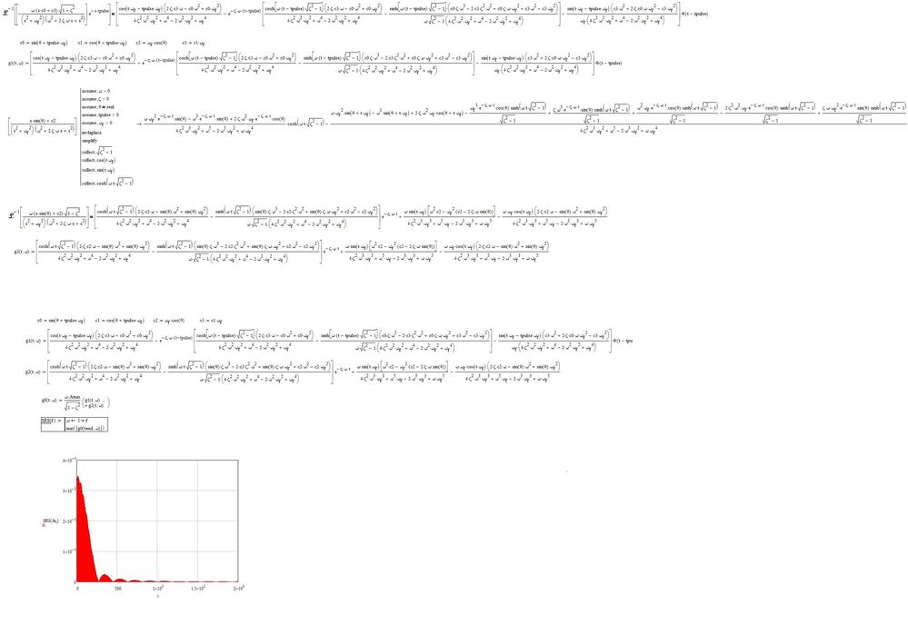

and a pdf for the prime user...
See attached pdf (from Prime express)

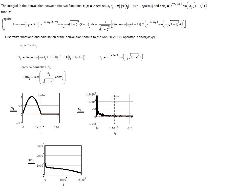

My interpretation of your problem is this:
Hi MF
I believe the interpretation is correct. It's the response of a 1 DoF subjected to an acceleration (ab(t)). I am using a half sine pulse as I am checking something  (trying to !) with a back to basic kind of approach. I want to plot different pulse duration ultimately.
Attached an update based on Fred's correction. Still dealing with your suggestion/check

my analytical solution:
MF
Unfortunately I can only clicked one 'accept solution'. I would have accepted your effort too If I could. I have looked at the kindly provided step-by-step example and learnt a lot. Thanks a lot
