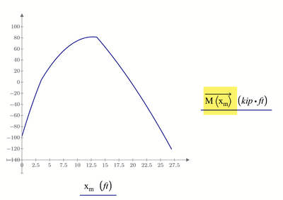

Again vectorization does the job
And again my question - why bother with the vectors when you simply want a plot of a function to be done? (Thats what Excel people have to do but its not necessary to do so in Mathcad or Prime).

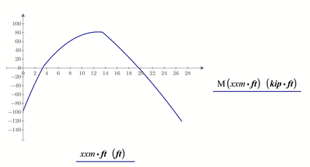

You may also use Primes Quickplot feature which means that you don't have to define the variable (xm) for the abscissa at all (neither as a vector, nor as a range). You have to edit the axis ticks (first, second and last) to get the plot done for the desired range from 0 to 27. Prime will automatically use appropriate values for xxm even though its not defined. But Prime will only use simple scalars. So if you need unit, you will have to multiply xxm by the desired unit and that doesn't look really good.

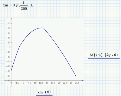

I find that its easier and gives better control to define a range variable like xm to be used in the plot.
