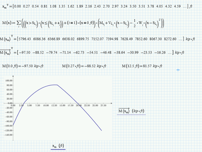

I worked through / recreated this worksheet in MathCAD Prime 7.0.
For the M(x) function, I noticed that you need to vectorize it when plotting or analyzing a range of variables. Otherwise, the results were incorrect.
...what, between Prime 2.0 and 7.0, would have changed the way it's calculating range variables?
January 2, 2024
I see that you already have seen my answer here -> https://community.ptc.com/t5/Mathcad/Simple-beam-analysis-moment-equation/m-p/920733/highlight/true#M209877
So you may consider closing that thread.
Nothing!
The pdf simply does not show how the plot was done - the axis expressions are hidden and the bold "M" you see is just a text field.
And its not about range variables - the variables involved are vectors.
