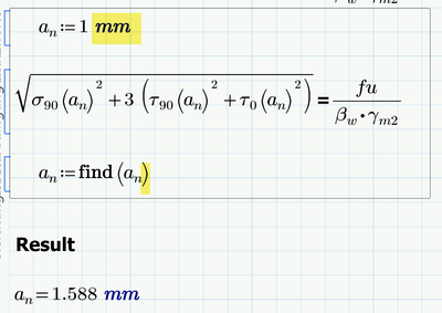

I am new to this Mathcad prime earlier I use Mathcad 15, I am trying to solve this equation in the Mathcad prime, but I am not getting the value, I also searched on the net but didn't find any proper solution.
Please help me to solve this issue.
To find the vale of the (an)
The file is attached

While the root-function as suggested by Fred is more compact and may be preferable in this case, I just wanted to point out the two errors you made:
1) Your guess value is missing a length unit
2) You had a typo in "find(an)" - there was an superfluous dot after the "n". Probably because you were used from MC15 to get the literal subscript by typing just a dot instead oft he more elaborate "Ctrl -".
P.S.: You sure know that "Given" is not recognized any more by Prime as being the start of a block and so this part is obsolete:

I only have Prime Express, so I can't check the operation of your solve block.  I can use the "root" function to solve your problem:
And I think if we assign units and use "Find" instead of "find", the solve block should work too.  Attached
Thankyou sir 🙂
