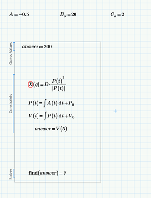

Hello
I am pretty new to mathcad. please help me to solve this .

Well, there are a few things that need to be corrected to make the solve block work, but do you really need a solve block?
Attached file (Prime 4.0) explains.

Prime can't solve integral equations, but it can solve some differential equation (at least numerically).
Not sure if the following would come close to what you are looking for (note that a^2/|a|=|a|)
The simple ODE can easily solved symbolically by hand (separable variables ), of course

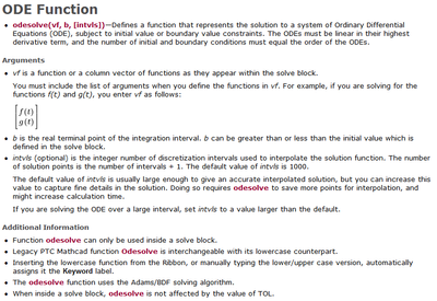

You can read in the online help information how you need to set up a solve block with Odesolve to solve a set of differential equations:

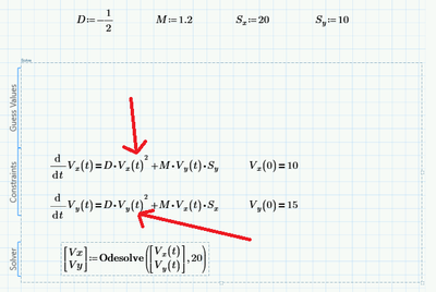

So in your case that would be solmething like:
But you also have to be consistent. Those (t)'s are necessary (red arrows).
This may be the result:
Prime4 file attached.

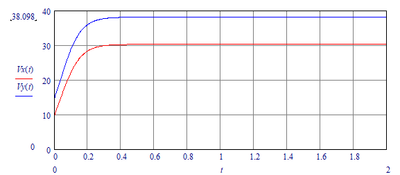

The solve block works when you limit the range of the ODESolve to 17 s of range.
You can see why from the graph of the solution.
See enclosed file.
