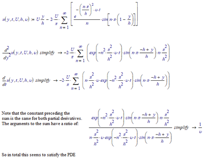

I could be wrong, but doesn't this have the following solution:
Correction: Penultimate line.  Where I wrote  if u(h,y) = 0 then ... I should have written  if u(x,h) = 0 then ...

Hello AlanStevens,
this Sounds like a good plan. In former days I have often considered the viscosity to be a non-linear function of the shear rate which made it a non linear PDE and though, not solvable by Separation of variables. But now, in this case, this might work. I'll give a Feedback once I found time to try it out.
Thank You 🙂

The solution I suggested requires p to be a function of x only, and to make use of it you certainly need to know exactly what dp/dx is.  Since you have a steady state situation I would think it’s not too difficult to relate the pressure drop to the mass flow rate.
