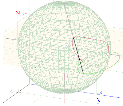

Hello everyone,
is there a very expert who would like to complete the attached work?
It seems to me to be quite simple.
Thank you very much for who will try to do it.
Greetings

24-Ruby V
(To:-MFra-)
Looking for something like this?
And in case that Valery is around ...

-MFra-
(To:Werner_E)
That's exactly what I was looking for.
Thank you very much Werner, you are unmatched.
YES!!
But can you do it in Prime?
