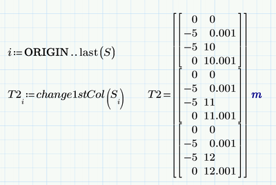

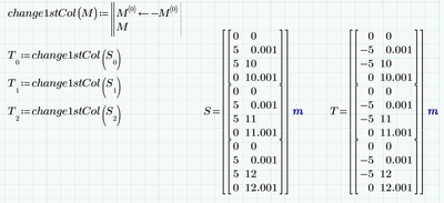

OK, here are some ways to do what you want. It helps to write a small function which changes the signs in the first column of a matrix and call this function multiple times.
Its less work using a range variable
and if you need the same procedure multiple times, it seems to be the best idea to create a function which handles a nested matrix the way you need it to be done

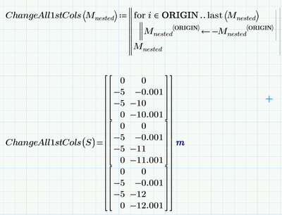

(To:awibroe)
Are you trying to create a nested matrix?
Something like this?

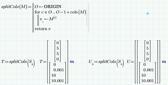

(To:awibroe)
If MJGs guess is correct, this could be the program you are asking for:
