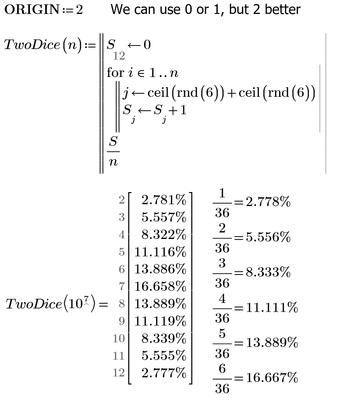

New Fig. 16.2 and the Mathcad Prime 5 sheet in attach

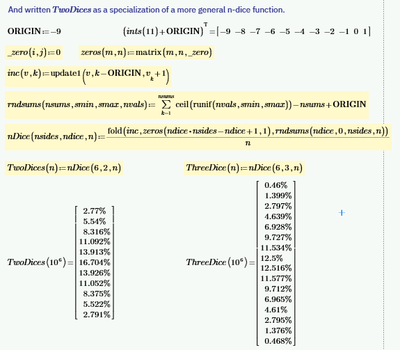

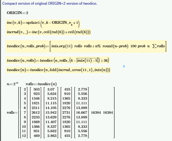

Having followed the chain of messages from the "continue" thread, I thought I'd Expressify the calculation using Werner's recently discovered, undocumented, built-in function update1.

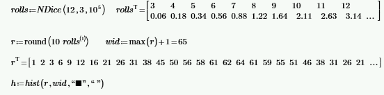

A somewhat meandering Mathcad Express 7 worksheet is attached - I was just putting stuff down as it occurred to me.
Stuart
(To:StuartBruff)

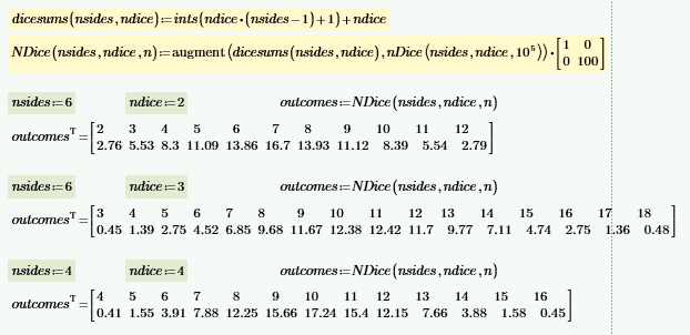

Didn't you intend to replace the 10^5 in the definition of" NDice" for the third function argument "n" ?

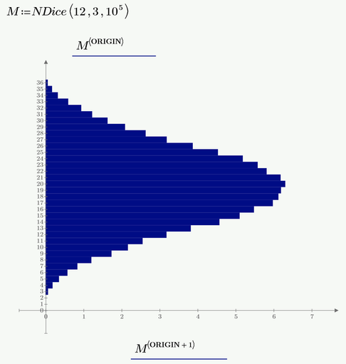

BTW, here's a first attempt for a graph showing the rolling of three dodecahedrons.
I had a "great" time formatting the display because of Primes idiotic implementation for resizing matrices 😞

@Werner_E wrote:
Didn't you intend to replace the 10^5 in the definition of" NDice" for the third argument "n" ?
Yes.   Well spotted.
Cut & Paste Error, of course. ☹️
It was a bit of a rush job and I didn't have time to review it properly ... although, I still might have missed it.  I don't normally spot errors until after I've posted a worksheet, anyway.  😁
Stuart

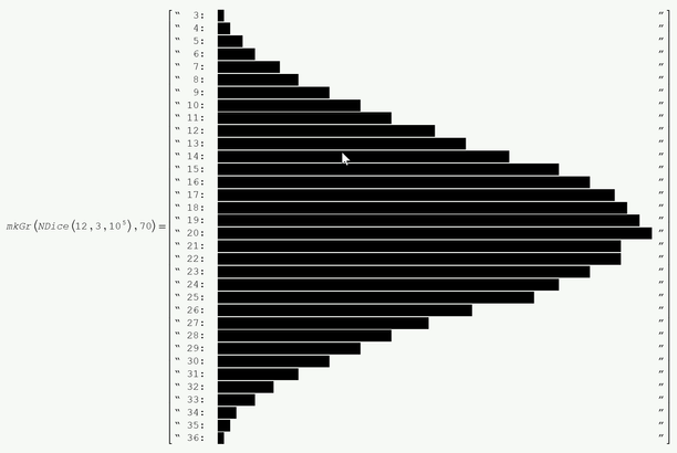

Instead of the output shown above, I sure would prefer something like seen in the picture below, but I am not well versed enough in "programming" in Prime Express to do it,
But of course we always can use  Prime's "outstanding" plot skills
Hah Hah! 😂  Been there, done that, burned the T-shirt, stuck pins in a voodoo doll of whoever thought it was a good idea to manually expand a large nested array.

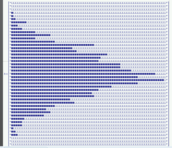

I wondered if iterating over a range variable might look better.  It doesn't.

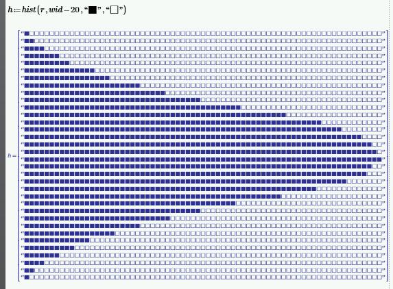

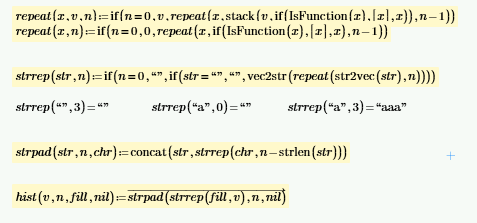

I then wondered if a stringogram would look any better ...
(I'm lacking the energy and will-power to build the scaling into hist)
I found a larger filled square character but not a matching space character.
Stuart

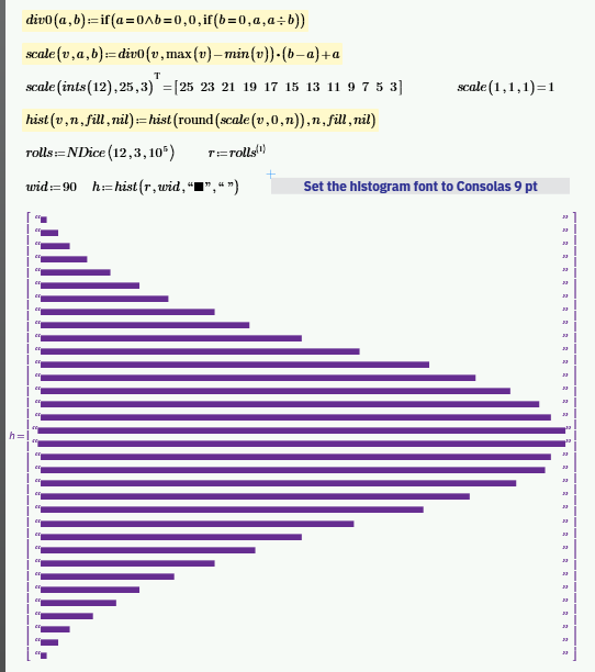

A nice cup of tea has wonderful restorative powers.

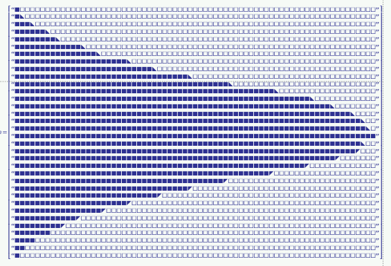

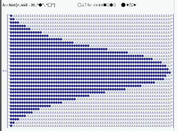

The best I could manage was contrasting characters.   Not sure it was worth the effort.

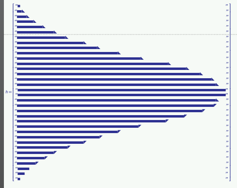

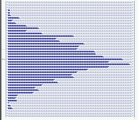

I was toying with the idea of using half-filled diagonal characters to improve the appearance of the slopes.   But I'd run out teaspiration, but after another cup of tea, I managed to sort of do it.   Not sure it was worth the effort, either.  I feel like I'm back in the days of ASCII Art.
"Normal"-sized characters don't quite align properly with the filled-diagonal characters.
I don't suppose I need to say that some form of String Markup Language (RTF, HTML, whatever) has been on my feature request list since pterosaurs first took to the air, do I?   Oh, and the ability to lose the quote marks - they're usually far too obtrusive for my needs.

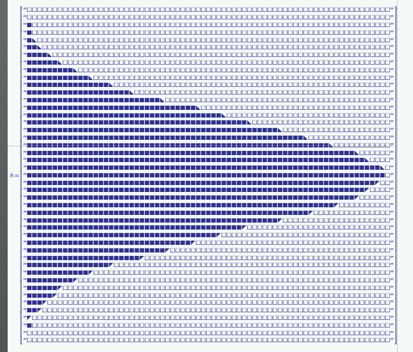

BTW, the encircled diagonal character - isn't it the wrong one?
Look, if I need criticism, I'll ask my wife!  I knew it wasn't worth it.  👿
No, it's the right character.   It merely happens to be in the wrong place.   It can happen to the best of us.  😇
Unfortunately, you've opened a can of worms.  What I'd intended as a simple demonstration has now escalated into a full-blown development, with functions and stuff, instead of just a simple range-variable scan of the "histogram".
Even more unfortunately, it's never the rarely the heart of the problem that's an issue, it's the edge cases.
I thought I'd semi-fixed the algorithm,
but, no,
I hate edge cases; they have a nasty habit of ruining the elegance of an algorithm.  😭
