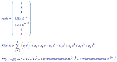

LucMeekes
(To:regcurry)
Make sure you undefine x numerically, before doing the symbolic. With x some range, the symbolic is trying to get a symbolic solution for each of the values of x, that takes time if x is a large range, and the symbolic result is going to be huge...
So put an
x := x
To the right and above your symbolic evaluation F1(x) ->
But, looking closer to your sheet, you have numeric data. What do you expect the symbolic evaluation to show?

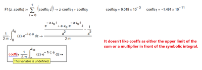

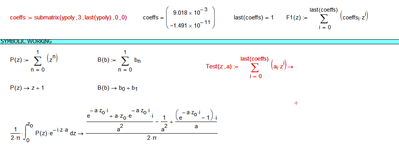

I got a little further.  The sum works this way, but not if I use last(coeffs) as upper bound on sum.  Why does it not like me using the coeffs vector elements either as an upper bound on the summation or just a constant in front of the integral?
Thanks much as always.
Reg
LucMeekes
(To:regcurry)
This may be dependent on how you got to coeffs... When you symbolically evaluate an expression involving coeffs, Mathcad will want to 'know' how coeffs got to get its values. If that involves operations that the symbolic processor does not support, then coeffs will be symbolically unsolved (that differs from being symbolically undefined).
Then why does it allow the upper left expression, you ask?...
Well the F1(z, coeffs) := ..... expression defines a function F1 of two parameters. You can use any parameter names  there. You chose z and coeffs, but you could have chosen a and b just as well, AS LONG AS you use those same names inside the definition (to the right-hand-side of the ;= (definition operator. The parameter coeffs in that function is NOT the variable coeffs that you have (numerically) defined (apparently, because numerical values of coeffs[0 and coeffs[1 are known) on worksheet level.
Now if you try to symbolically evaluate the F1 function with:
F12(z, coeffs) ->
then Mathcad uses the values of z and coeffs as they are defined on worksheet level. If one or both are undefined, then that's OK for the symbolic processor. It will use their (symbolic) names. If one or both are defined, it will use the definition. But if one or both cannot be solved symbolically, you get this error,
I hope this sheds some light.
P.S.
In Mathcad 11, I get this:
Apparently the regress() function cannot be symbolically evaluated, so Mathcad simply uses the definition, symbolically.
I suppose Mathcad 15 will throw the undefined error.
