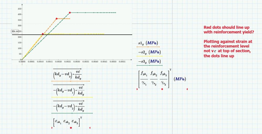

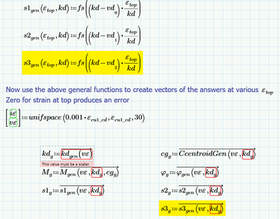

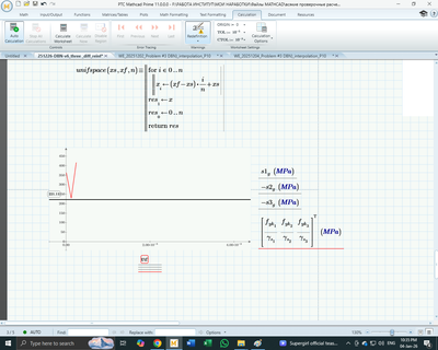

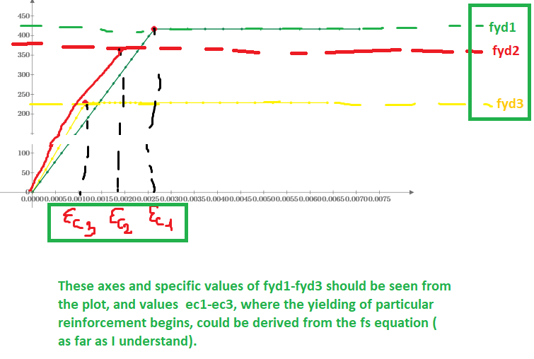

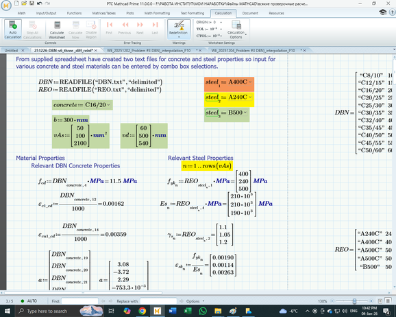

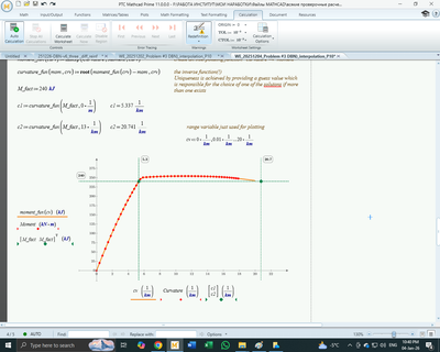

Happy New 2026 Year, Terry!
I tried to modify the original file a little, adding extra reinforcement (a total of three), each with different characteristics (e.g., A240C, A400C, B500).
But my plot is not represented, due to the syntax errors (probably)
I also liked observing how each reinforcement stress is changed along the ec1 axis. It means that I want to draw the fyd of each reinforcement and to fix the range where the stress is above/below this line. The idea of drawing the horizontal line  in the form of a transparent matrix [] T was taken from @Werner_E file,
but also without results.
Can you look at what is incorrect in my attempt, please?
I'll be very grateful for any assistance with my question.
PS All my modifications are highlighted in yellow.
Prime 11.0.0.0 file is attached.
Happy New Year to you as well.
Comments in red where I have made alterations to get it to work.
Still not 100% happy.
Cheers
Terry
Changed the diagram of reinforcement stress-strain.  Replace strain at the top of section with strains at the level of each reinforcement.
Cheers
Terry
Thank you for upgrading the code, Terry!
I still don't think I expressed my issue clearly.
The idea for the improvement is to analyse the bending moment M (bearing capacity) as a straightforward function of different areas and reinforcement grades.
Thus, I want to explore how varying the reinforcement level, area, and yield strength affects the moment M for a specific reinforcement stress value at a fixed strain, for instance, the 0.2ecu1 level.
I thought that for such a purpose, the additional axes (fyd_n for each reinforcement grade) plotted with dots, whatever, would be useful with both horizontal and vertical axes (stress-strain for each reinforcement grade) in the form of "sights" as in the @Werner_E  file, as follows:
The possible representation of the aforementioned could also be as follows:
I found that the technique of plotting the dot lines for specific values of fyd can be used from the other file (see @Werner_E file, where, instead of Moment-Curvature, I would like to use Stress-Strain diagram). This is the idea. I tried to modify it with my data, obtained courtesy of you and @Werner_E.

Maybe I don't understand the logic of MathCAD, but why in one case (Case of one-layer reinforcement), where I assigned the Curvature value by
Everything was seamless.
But unfortunately, after hard work with several mistakes corrected and thorough input, the same Curvature value for double reinforcement caused an error in MathCAD...
I'm on the edge of being broken.
With my "coarse" understanding of MathCAD logic, it seems to be the unexplainable issues, for me at least.
Sorry for annoying you, but I'm really trying to understand where there are possible **bleep**ups and to fix my issue.
File attached
(To:Ivan_Pat)
Your program is impossible to read for me and i was hardly able to play around with it because Prime gets unacceptably slow in reaction.
I tried to throw in a try-on_error statement at the position of the error to see when the error occurs and would return "i" and the vector "ec2" in case of an error.
It showed me that the error occurs when i=3, but my attempt to show the returned vector ec2 failed because Prime would crash.
I saw the error "Unknown error: The method or operation is not implemented" without any clue as to which 'operation or method" the message would refer to.
I looked closer (not too close as of the prohibiting large expressions) at the definition of ec2 and noticed, that you don't return a value in case none of the conditions in your many if, elseif statements is met.
So I added an "else" at the end which guarantees that ec2_i would get a value in any case.
This at least makes the program work but chances are you get some wrong values because of the arbitrary value 12345 used. This means that you should recheck the logic of the calculation - there seems to be at least one case which you did not consider correctly.
And, as I already wrote in a prior reply, your if, if else,... calculations should always return a value. This usually may be achieved by using a simple "else" as the last statement. This is where you land if none of the other conditions are met.
