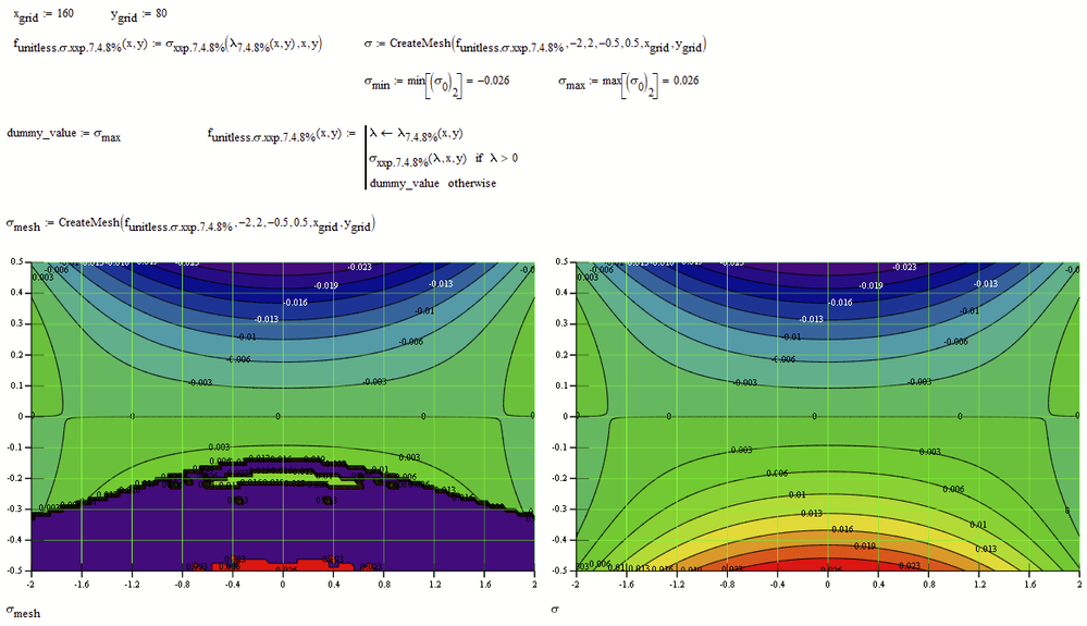

I'm going to present only Sigmaxxp, for λ>0 How can I do?
(To:ptc-3682623)
The function you define is dependent on THREE arguments (lambda, x and y). You can only plot functions dependent on TWO arguments with the 3D plot. Thats exactly what the error message is telling you.
Its still confusing that you use the very same name for a function and soon after for a variable.
ptc-3682623
(To:Werner_E)
Now is ok, but I'm returning to my question how can I plot 3D graphs only for lambda >0. This means graphs of sigmaxx must to be similar to lambda where we plot only lambda>O. We need plot strees only in this parts where lambda >0. If this is not clear what I want to do ask me.
(To:ptc-3682623)
You would have to define an auxiliary function which returns the function value of sigma if lambda is positive and a dummy value otherwise. Unfortunately unlike 2D-plots we cannot use "NaN" as value in a 3D plot in Mathcad. So I guess you will have to settle with a dummy value which fits best. Note that the coloring will change if you use a dummy value outside the normal range of function values of sigma. So in the picture below I tried to use the maximum value of sigma for this dummy. You may experiment with other values.
MC15 sheet attached

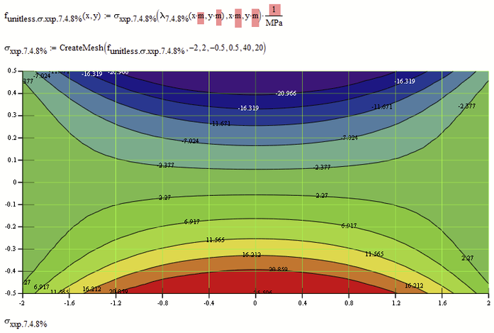

Thanks for it:) Now I do not know what is wrong with it. I promise you it will be the last one question if all be ok. Look at attachment
(To:ptc-3682623)
I stopped at the first error shown-up in your sheet.
You didn't made your function unitless!
