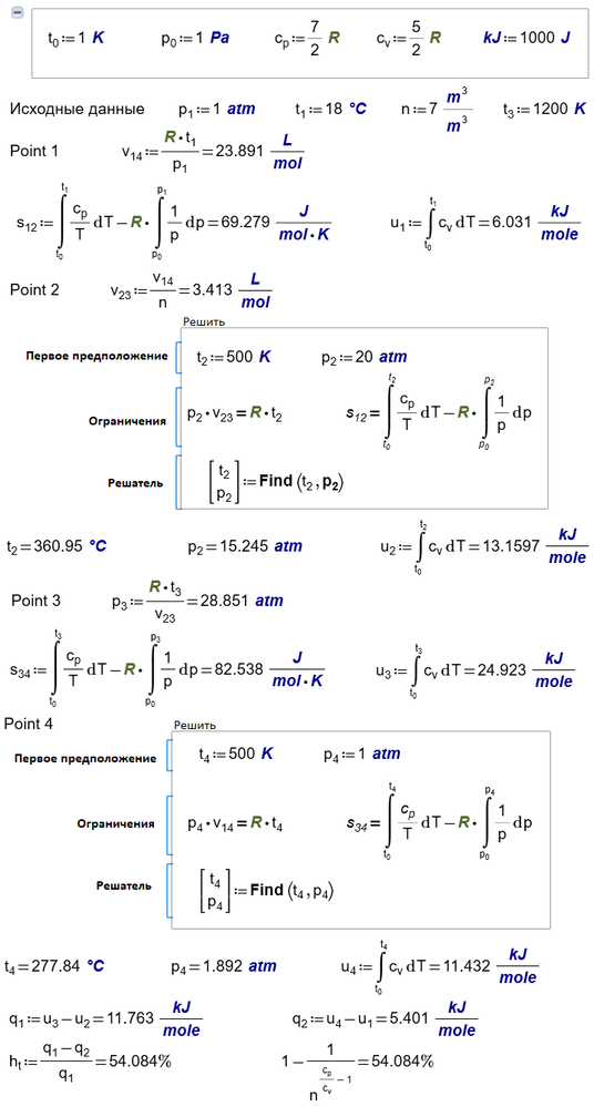

I think I get the concept of using a solve block in this scenario. I could set limitations and then ask to find P2.

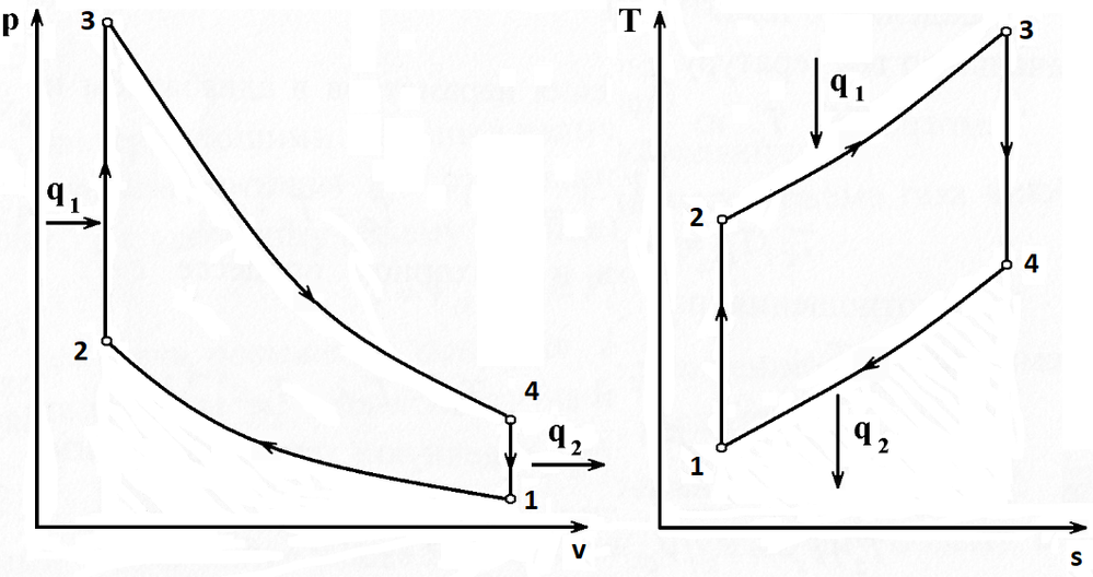

Try please this Mathcad Web sheet with Carno Cycle calculation with 2D and 3D diagrams
http://twt.mpei.ac.ru/MCS/Worksheets/Thermal/carno.xmcd
and more http://twt.mpei.ac.ru/TTHB/2/tdceng.html

May be one example with Otto cycle help you
