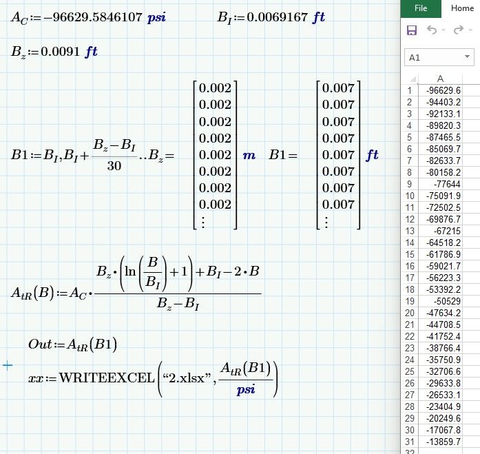

I have used units but when writing the function to excel I am getting error. Please help

The problem is B1 is defined in your sheet as a range variable.
Looks in PTC Prime exactly like a vector.
To change it to a vector just use the hack of putting an equal sign after it to show it.

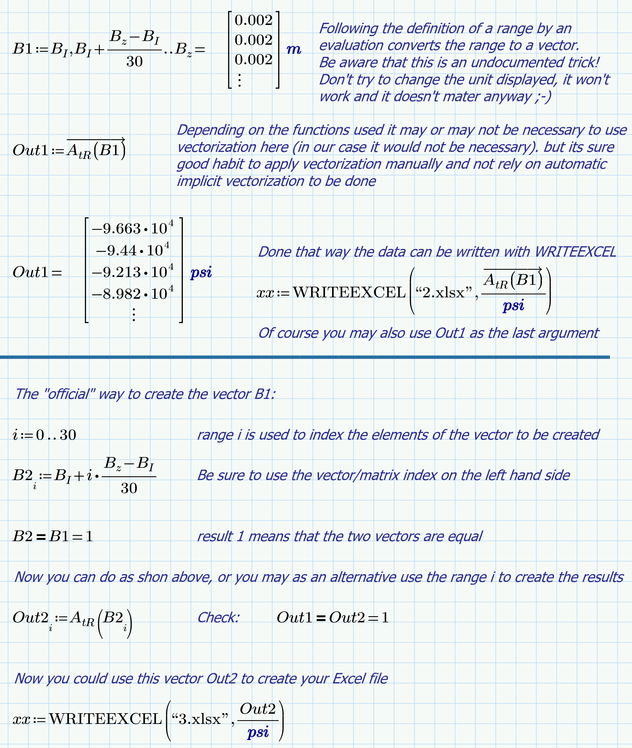

The problem is not WRITEEXCEL as you correctly strip the units when you use it.
The problem is that B1 is a range, not a vector, and so it can't be used as the argument for function A,tR.
Find attached two ways to deal with that situation.
