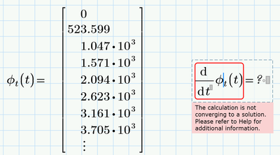

I am unable to get the evaluation of Derivative in attached worksheet.  How do I get it evaluated?

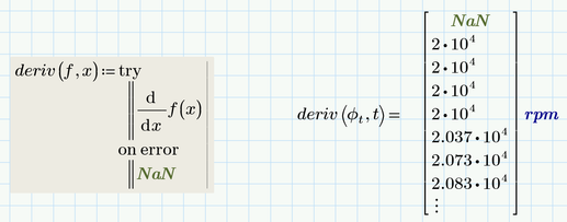

The calculation of the derivatives fails because of the end values (0s, 20s) as already explained
You may fix this by using try & catch
It may be worth to define a small utility function to do that job
!! !BUT ,,,

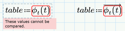

You can't assign these values to a variable for later use as its NOT a vector! So of course vectorization does not help at all
Despite of the misleading error message the true reason is (as written in my previous answer) that t is a range, not a vector!.

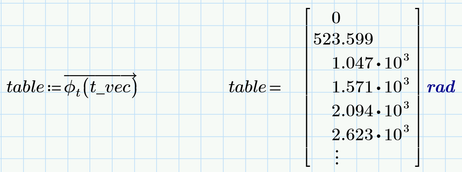

There is an undocumented trick to turn a range into a vector by following the assignment with an inline evaluation:
t_vec is now a legitimate vector, not a range (unfortunately ranges and vectors look the very same in Prime).
A more "legal" way to create that very same vector is seen here:

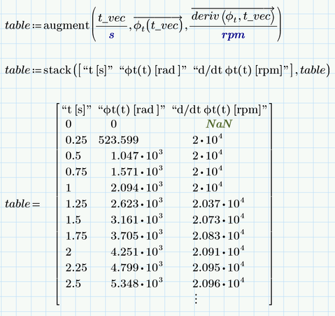

Now you can use this vector to create a table for later use - don't forget about vectorization (the arrow over the expression)
or create a more comprehensive table

But the problem is clear anyway: A solve block with odesolve returns a numerical solution, not a symbolic one. You don't get a symbolic function definition and so you can't demand a symbolic derivative.
All you can do is to numerically evaluate the functions at positions within the interval from 0 to 20 s and you may also numerically evaluate their derivatives as you already did in the plot. So Phi(2s)= will work, but Phi(t)= or Phi(t)-> can't - apart from the fact that you already defined t as a range!
!! !BUT ,,,
