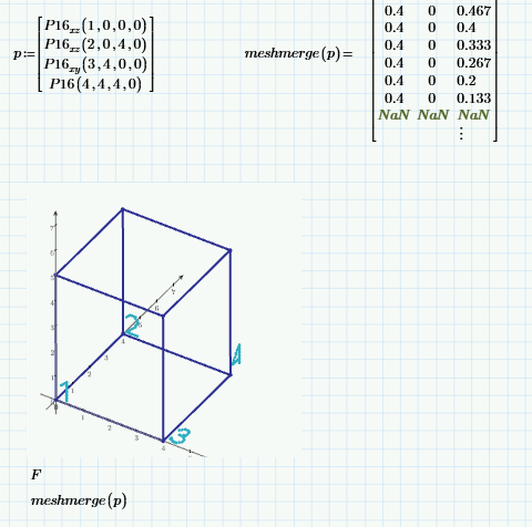

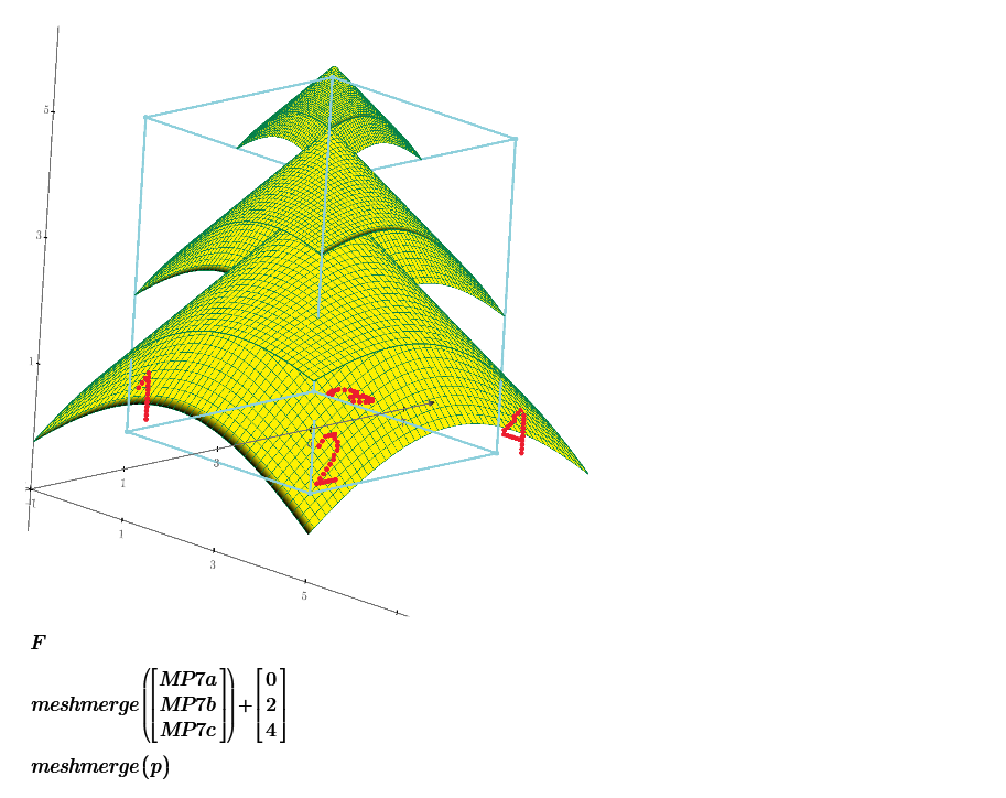

I do have a problem when joining multiple meshes, though.  I can't work out why there's a dark banding where the NaNs live.
The MP7 variables hold 3D meshes. vector p holds the first 4 numbers in Tetsuro's 3D Plot argument list.
Stuart
(I was playing around with Tetsuro's worksheet to allow a vector of meshes as an argument to the 3D Plot component. The function meshmerge takes such a vector and places NaNs between each mesh to create a single mesh.  It works on vectors of both 3-column xyz coordinate lists and of xyz planes)

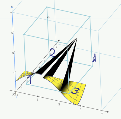

(To:StuartBruff)
Thats what I see in P6 (exchanging the NaN's for the imaginary unit 1j did not help and yields the same plot)
StuartBruff
(To:Werner_E)
Interesting.  It would seem they project to some point on the backplane (they certainly don't project along the surface normals).   I wonder why they're black and grade into the yellow surface? Neither the surface fill nor the line colour is black.
That's a nuisance and somewhat restricts the technique's usefulness.  I wonder if they can put a patch in before Prime 8 gets released? And add colormaps?  (I love rhetorical questions ... 😈)

I suppose some kind of improvement is already there, going from Werner's Prime 6, apparently showing that NaN is out there somewhere and the plot reaches out to it, to your Prime 7, where NaN's are some kind of black hole, the position of which is indeterminate...
What would you want Prime 8 to do further with it?
StuartBruff
(To:LucMeekes)
Yes, that's definitely an improvement.
However, was it intentional or just a side-effect of some other change?  If the former, why wasn't the colour gradation dealt with?
Treat NaNs as a complete break in the surface, which is what they do for a non-filled mesh.  So, a filled surface would not have "NaN edge gradation".  Either that or revert to using & plotting nested 3D-meshes to handle objects with multiple surfaces.
It goes without saying that I want colormaps.  I'd also like to be able to set independent depth ranges for each plot entry (to address such cases as @-MFra- 's contour-mapped sliding surface ... or to have depth-positionable contour maps).

(To:StuartBruff)
That "center of projection" changes when I change the axis limits. It seems to be the center of the surrounding box.
Looks like they improved the shading algorithm a little bit when they went from P6 to P7.
Just be careful with your wishes! We wished they would improve 2D plotting an we got ... a badly integrated third party tool which does not support units and has a lot of other drawbacks.

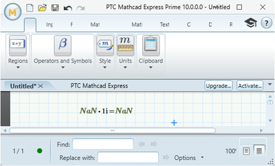

Here is something strange (sligthtly off-topic) which I found while (unsuccessfully) playing around.
Is it a new unknown "unit"? At least its labelled  as such. 😉
In real Mathcad the result is simply NaN, as it should be IMHO.

The unit NaNi is not only unknown, it's also undefined:
Together with the double negation in the exponent of 10, this is a sign of serious trouble that should be reported to the officials!

The bug was still present in Prime 9 but seems to be fixed in Prime 10 - At least it is in 10.0.1.0

It's solved in Prime 10.0.0.0:

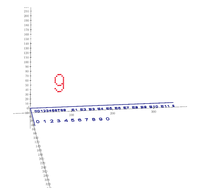

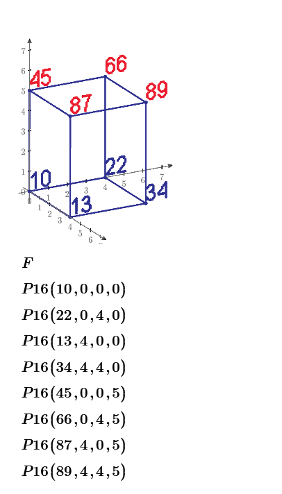

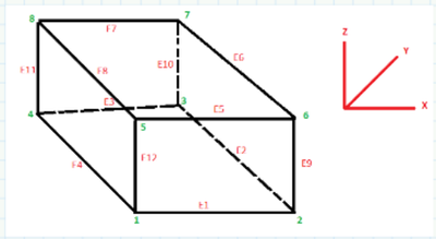

@LucMeekes  If you could share another 3D Plot Function Sheet , it's the best.
that can apply in construction Text in 3D Modeling as picture  below or in general
Using image data to plot the numbers by dots.

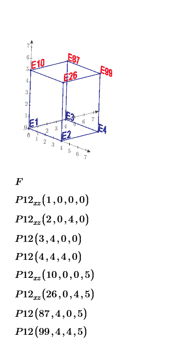

SPRstructur
(To:ttokoro)
@ttokoro  when I change ORIGIN=1 not working well and number more than 9 it not appear that number
SPRstructur
(To:ttokoro)
now, n=0 to 99 you can 3D plot. If you want to change the ORIGIN to 1, you should change the program.

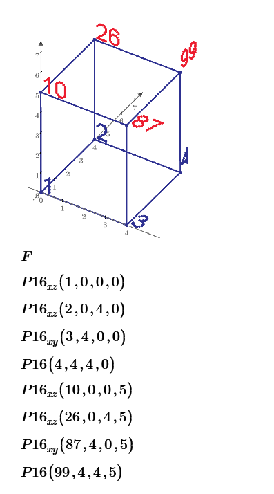

@ttokoro  I try to change ORIGIN=1 in program but error
The one of ORIGIN free.

@ttokoro that great , could you do for general for input Letter or Number no limit (not only 1 to 99)?
Best regard SPRStructure
Using Luc's function, all letters and numbers you can plot as shown in  my post at 01-04-2022 11:14 AM.
